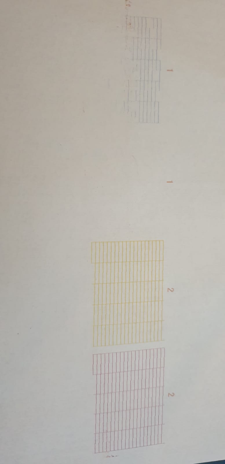

Doing a nozzle check and the black and cyan is not printing. When I try to print something in black, it just comes out magenta? any ideas?

I am flushing with the new ink installed. The ink is also good quality from a reputable supplier.webtrekker;140167 wrote:The Ricoh Service Manual says 'Air sensor error.'
When you say you are trying to flush the print head, do you mean with the original ink still in the machine? Flushing uses a LOT of ink so maybe the carts are emptying and air is being drawn into the system.
Anyway, when I suggested flushing out the old inks and replacing with new, I meant flushing with new inks installed as I think it's the old inks that are causing you problems. Personally, I'd buy new carts and fill them with good quality inks from the likes of @InkExperts (who advertise in the forum), or City Ink Express. There's a procedure for swapping inks that needs to be followed and I can PM you a PDF file to follow should you decide to do this.
When I try flushing the head with the new ink, I get the "Air sensor error". I think once I can get a full head flush, my problems will be resolved. It's just getting there. Any advice as to what could be causing the printer flush error?
