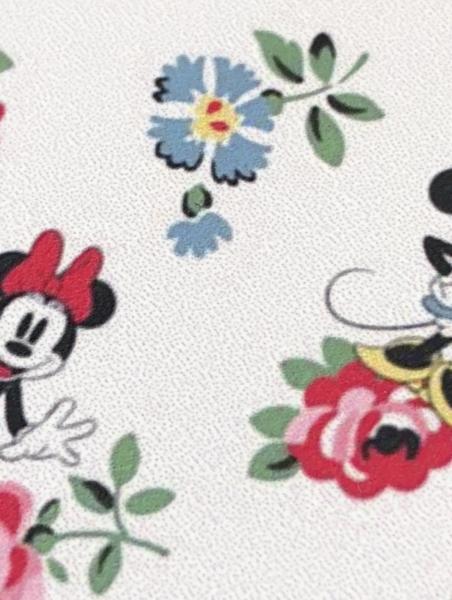

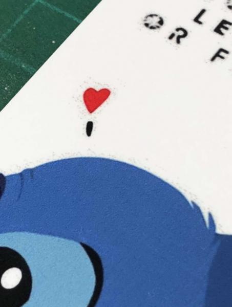

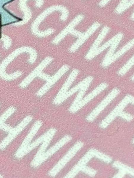

Hi I have been having this same issue for some years now and not been able to sort the problem.
I still use Ricoh 3110dn printers as well which don’t have the problem but are end of line so difficult to get hold of now and so have always wanted to change over to SG400 but had the problem which two of them I purchased, only using them for printing onto soft substrates which doesn’t show the problem as much due to texture of for example a pillow in comparison to an aluminium sheet.

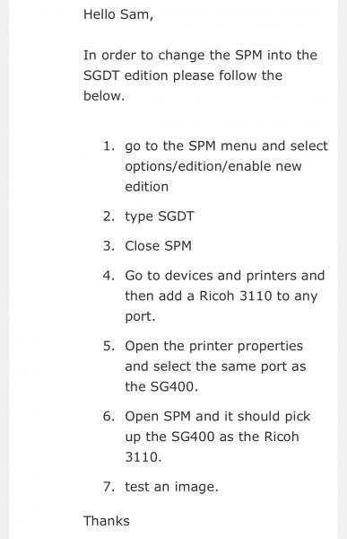

I did hear of a solution from Sawgrass which allows you to use the colour profile designed for the old Ricoh 3110s which can be easily switched over to as they have it in built into the newer VPM, I tried it but did not make a difference for me.
it anyon else finds a solution let me know.
Attached images show how to change over to the different colour settings designed for the Ricoh SG3110dn as provided by Sawgrass, interested to see if it fixes the issue for anyone else. Also examples of the problem attached test prints.
thanks
