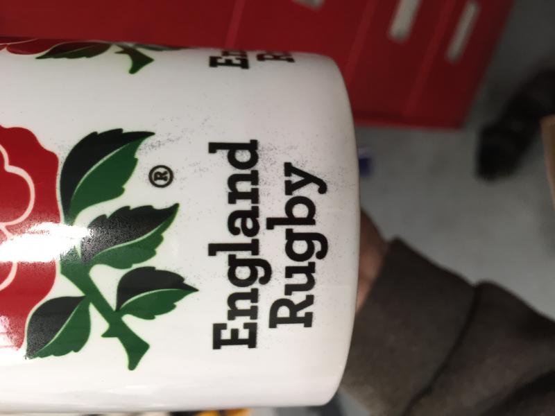

Possibly ink splatter?? help.
Mhd
Posts: 14
Joined: 02 Oct 2017, 21:13
Re: Possibly ink splatter?? help.
Post by Mhd »
Hi,
iv been doing sublimation for a few years now and had minor problems before and with the help of the forum search Iv got over them. This issue I have now has yielded now results in the search. Printing the same image as I have done many times then pressed it without checking the print fully (mistake) then pressed as normal only for it to come out like the photo attached then I printed again and if I can look closely I can just make them out.
many thanks
Mike
vB_ID:6095
vB_ID:6095
Mrteajunkie
Posts: 1234
Joined: 13 Nov 2016, 21:59
Has thanked: 5 times
Been thanked: 3 times
Post by Mrteajunkie »
Is the ink on the sub paper visible before pressing then?
Mhd
Posts: 14
Post by Mhd »
Yes they doo seem to be there but hardly noticeable, to the point I think I can see them in some parts but not in others and after pressed it’s all over.
Hi. What's your setup - printer, inks, paper?
Mhd
Posts: 14
Post by Mhd »
Epson wf2630 city ink express inks & paper. Using illustrator with a custom icc set up by city ink. Been using fine for a long time. Could it be weather effected?
