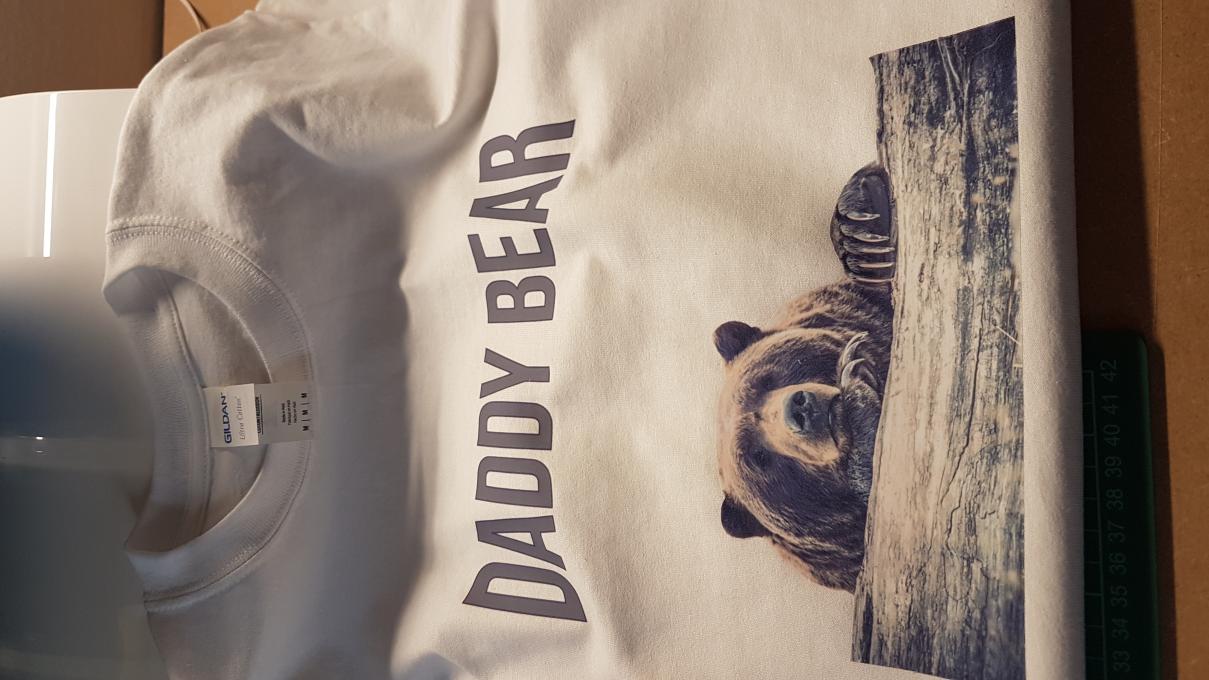

You can use siser easi subli for cotton, I have mastered it now and you can adhere it to 100% cotton 155 degrees for 15 seconds.[ATTACH=CONFIG]6196[/ATTACH]

billy8581;143175 wrote:You can use siser easi subli for cotton, I have mastered it now and you can adhere it to 100% cotton 155 degrees for 15 seconds.[ATTACH=CONFIG]6196[/ATTACH]
That's a solution, but I'd imagine it has a 'hand' to it, like HTV, and also, of course, you need a vinyl cutter, so a more expensive initial setup and extra time spent weeding.
Have you wash-tested that stuff billy? I'd be interested to know how long the print lasts, and whether any brand of sublimation inks can be used.
Re: dull print

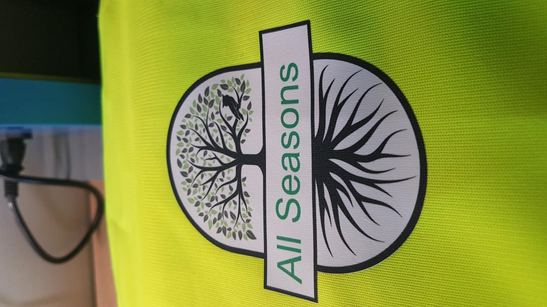

Hi Web. The hand is very impressive. Like a thin htv sports vinyl. Nothing like the solvent printed logos you get on the thick backing. The wash-ability is very impressive too, I cannot see a difference in the before and after, having washed some designs 5 or 6 times. I always wash them inside out, and it is recommended that you don't go above 60 degrees. I like them for printing high vis vest logos[ATTACH=CONFIG]6197[/ATTACH]
Im using Sublijet HD inks and they are very good. They recommend you use easi subli, but I can tell it really doesn't matter.
