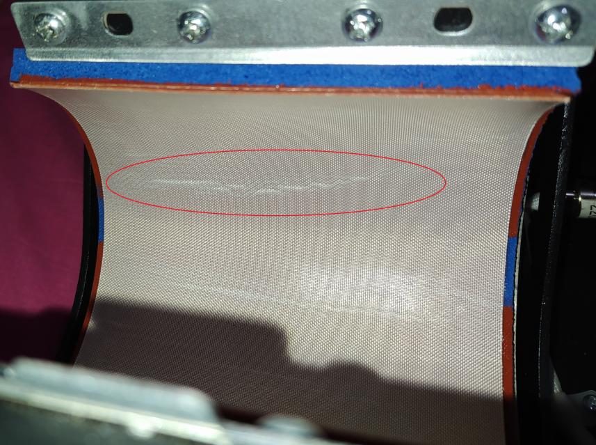

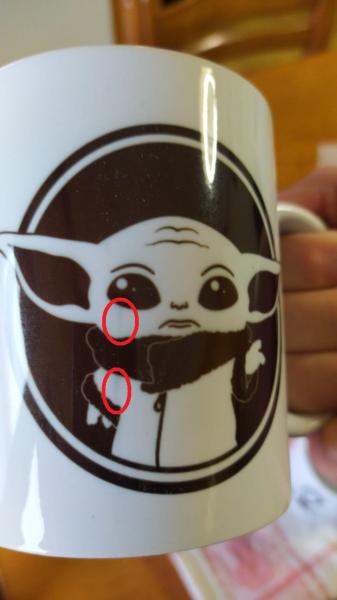

I have a problem with my mug press. The heat platen has some crumples, and one of them makes me a problem. After pressing the mugs there is something like a blur, or this spot doesn't pressed so well. Is there a way to avoid these problems?
Check the images.
[ATTACH=CONFIG]6482[/ATTACH] [ATTACH=CONFIG]6483[/ATTACH]
Mug press issue

If your experiencing problems with the heat element, I personally would replace it. Not worth the time trying to fix it .rafinos;146607 wrote:Hi guys,

Re: Mug press issue
Thanks for your advice!
Can I buy any heat element with same connection like mine or I have to notice something else?

Re: Mug press issue
Yes you should be able to. If you know the make or model of your press you should be able to get a replacement.rafinos;146615 wrote:Thanks for your advice!

Re: Mug press issue
if your BIZ is making and selling mugs, you should always have a spare element ... they can last 100 or 5000 mugs ... but they always fail .....
fail, without notice, so ... when you get a new element, get TWO !

Re: Mug press issue
Which mug press is it and what age? Most suppliers do warranty the elements but only for a very limited time. If your mug business can justify it get a good machine (assuming this isn't) and it will pay for itself in no time.
