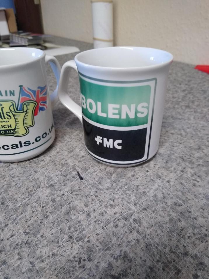

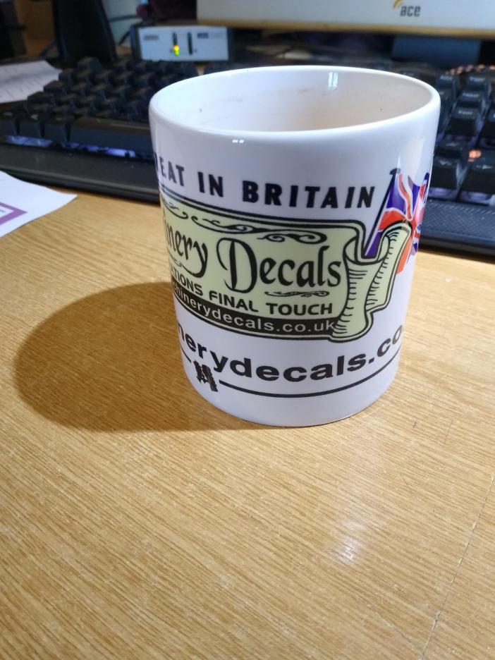

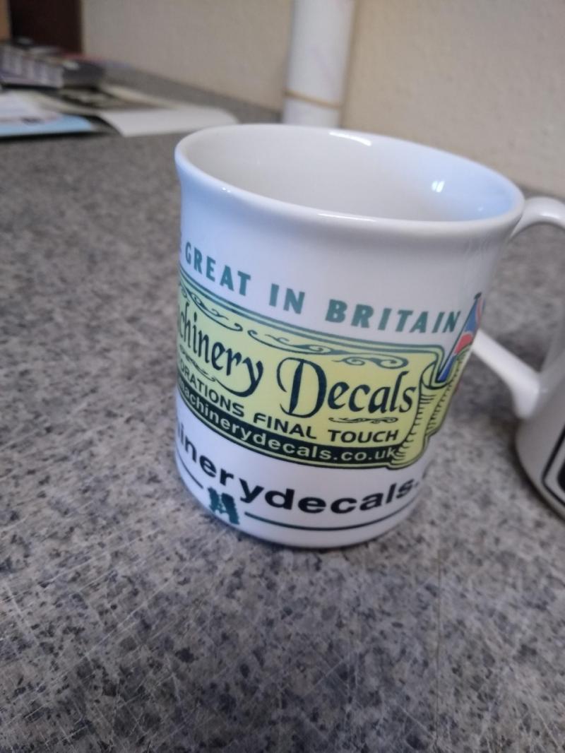

Durham mugs, fine..quite happy, However.. Sparta mugs, which are far far more favoured by myself, in that I'd prefer to have & use Sparta mugs only..but, when printing, they fade out, mostly, at the top or centre upwards.. I have tried a few variations on timing etc but appreciate they may well be a slightly smaller diameter etc plus that 'lip'
Do I put the whole mug, covering the lip within the heat blanket on the press, is there a specific heat blanket I should be using?

You will have problems printing the way you are. You will find that using an insert to wrap around the mug below the lip will resolve the issue. I used an heat resistant silicone rubber sheet, if I remember rightly it was 3mm thick. You'll then need to adjust your temperature and timing.

Nice mugs but like janners suggests you will need a spacer between mug and blanket as the lip will stop the contact to the rest of the mug.
I only pressed 10mm from the lip down.
and I used the standard 10oz blanket.
