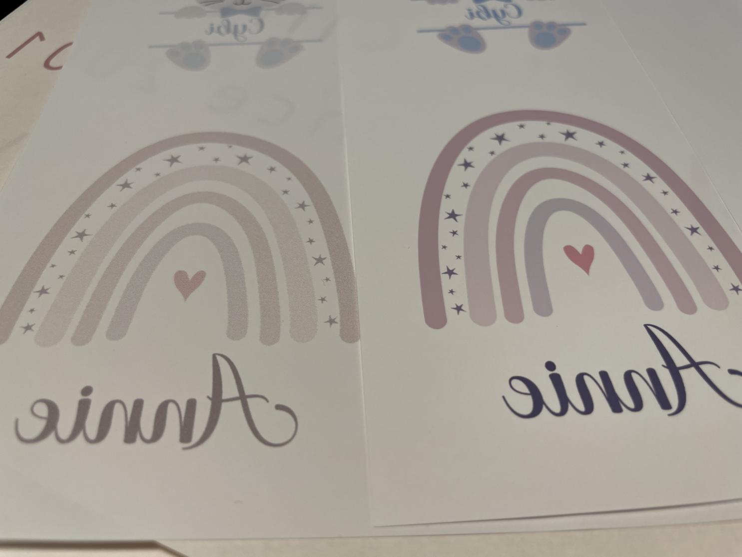

I've attached a photo to this post showing the exact same file printed on the exact same paper, on the left print is the SC-F100 and on the right print is the L1800. You should be able to see that edges of the rainbow on the left are not smooth, and are filled with what looks like tiny dots, these are visible after pressing and makes the transfer appear grainy.
I have tried 3 different papers, EPSON DS General, InkExperts Style & S-RACE 120 all produce the same results when printed from either the SC-F100 & SC-F500. I've tried both of the included EPSON ICC profiles (Rigid/Textile) as well all the different quality settings and the results the same.
Has anyone else had similar experience with either of these printers? I'm thinking this can't be right, surely I'm missing something or doing something wrong?

A couple of days ago I got both the EPSON SC-F100 & SC-F500, previously I was using an EPSON L1800 with Sublinova inks and InkExperts ICC profiles, so that is what I'm comparing them to.
My findings so far is that the print quality I'm getting on hard substrates from both the SC-F100 & SC-F500 is completely unacceptable and isn't really of a sellable quality.

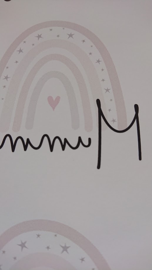

[ATTACH=CONFIG]6593[/ATTACH][ATTACH=CONFIG]6594[/ATTACH]
That's the example that I sent over to EPSON just now of print out from the SC-100 and a transfer onto a mug.

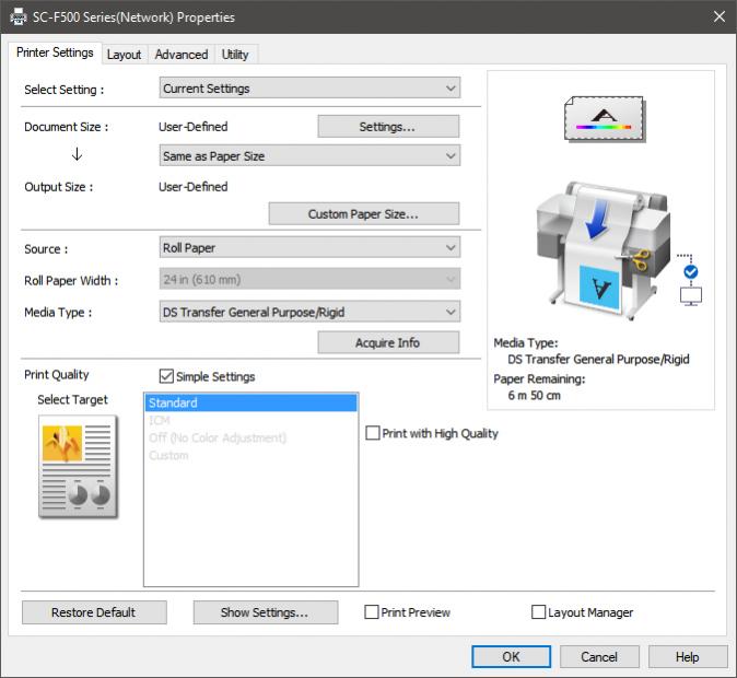

Print out from my SC-F500 using trupix paper. Settings I'm currently printing coasters and aluminium signs with.
I'd say the rainbow looks similar, maybe slightly sharper?, to your SC-F500 print but the black text looks more like your EPSON L1800 print.

Re: EPSON SC-F100 & SC-F500 quality issues
Thanks for doing that, doesn't look that much different to mine really I don't think.msub;147669 wrote:[ATTACH=CONFIG]6595[/ATTACH][ATTACH=CONFIG]6596[/ATTACH]
Do you not set the ICC profile within Photoshop? I think if you leave it on simple settings and standard there is ICM colour profile matching still enabled within the driver.
Thanks, on the SC-F100/F500 there is only two paper types in the driver both of them Epson DS papers so I can't select plain paper. I've run media adjust a couple of times and well a nozzle checks which come out fine.GoonerGary;147670 wrote:Is your Epson printer using a plain paper setting or a low quality photo setting in your profile? This will result in low quality images.
