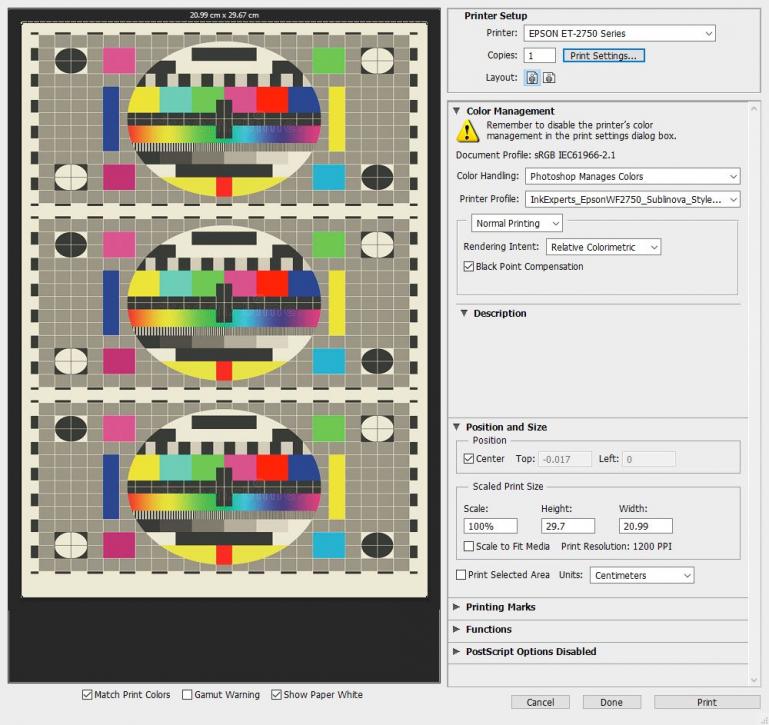

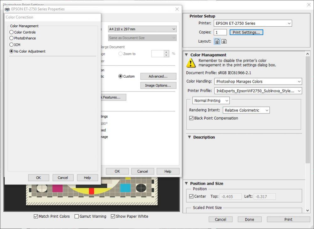

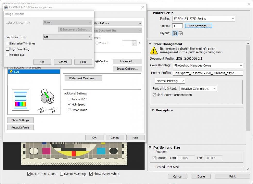

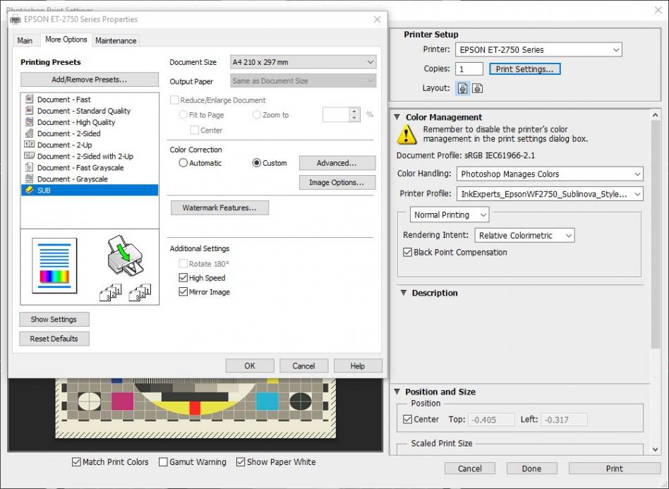

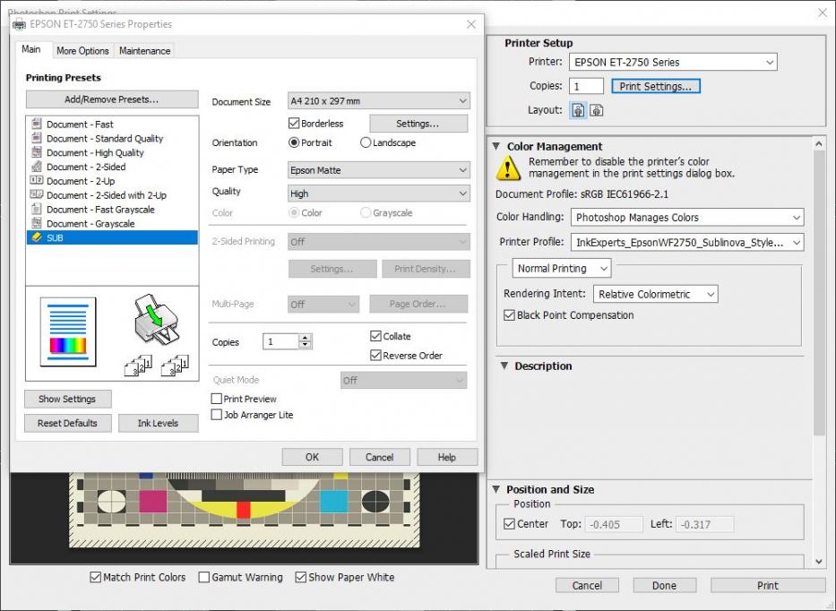

I use both mugs from Signzworld and MDP. I have always used these mugs, and before I got the Epson ET-2750 and Sublinova ink from Ink Experts the blacks were sharp and deep.
Ink Experts have been helpful, and send 2 ICC profiles. The colours are fine, the blacks are always brownish.
I have tried everything from 180c @ 150 Seconds up to 200c @ 180 secs.
To get a decent full coverage with no fading I use 150c idle, 200c cook temp and 150sec. But no matter how much temp/time the blacks are brownish. Even when there is fading at the edges still brown.
I am going to do 3 mugs tomorrow with a test pattern. 1 x 180c 180sec, 1 x 185c 185sec, 1 x 190c 180sec all at idle 100c.
I have attached my current print settings.
