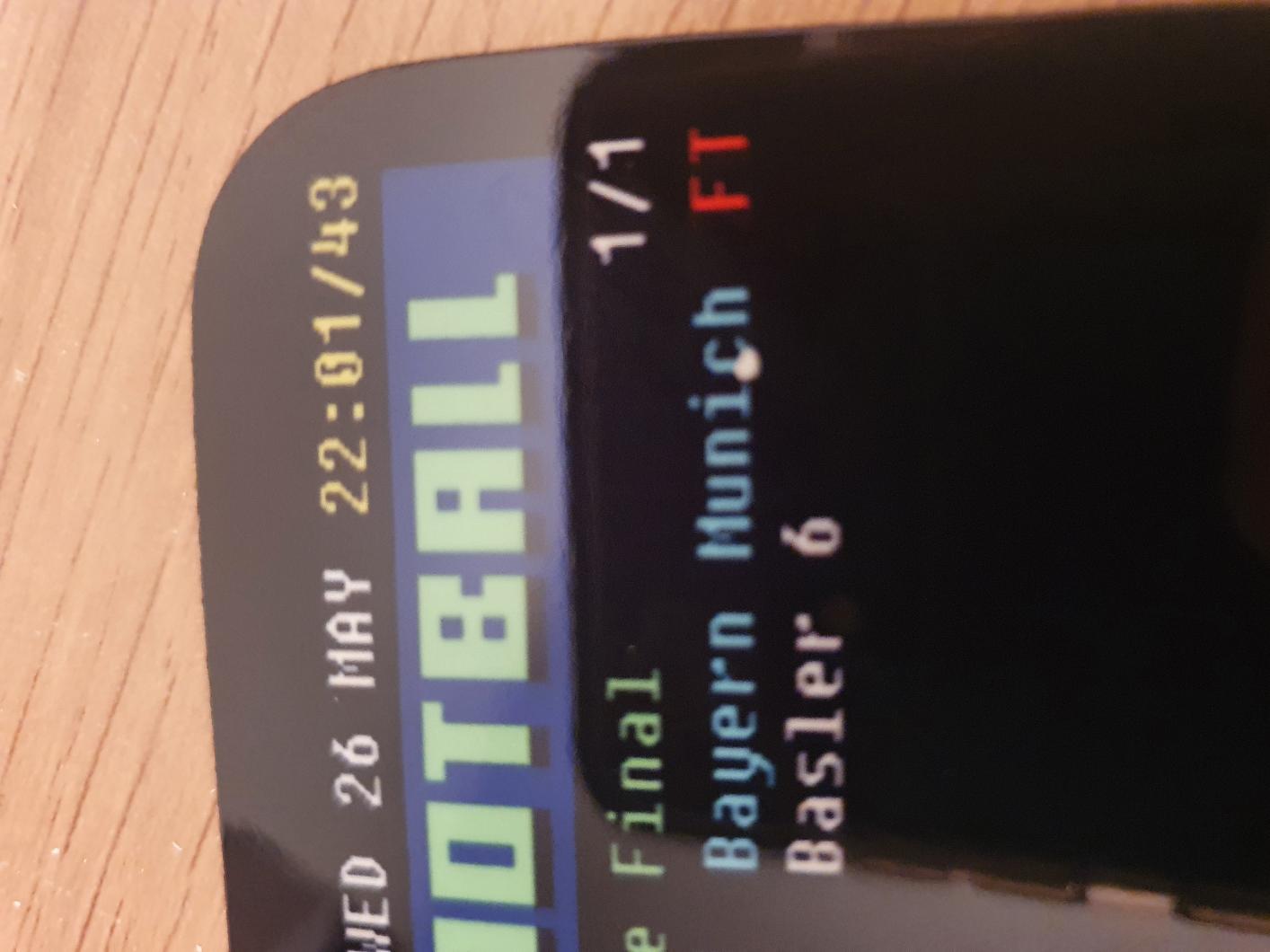

I am having some issues with the coasters I have tried multiple setups between 175-185 and 55-60 seconds it doesn't seem to make a difference. I have getting spots on the coaster that look to have peeled off and are stuck to the transfer paper. I use teflon paper as well. The reason I say it has peeled it because the park that is left on the paper is shiny as if it has pulled the top of the coaster off.[ATTACH=CONFIG]6759[/ATTACH]

You have removed the plastic before pressing?
The ones I use don’t have it though.
For reference I use 190c for 60s medium pressure.

Hi thanks for replying i am fairly confident they don't have plastic on them. I'll have to try 190. I assumed that if 186 was pulling the top of the coaster off I needed to lower something.

So doing this seems to have made it a bit better but I would still safe 1 out of 2 have the issue. Rather than like 1 out of 5 was right.
