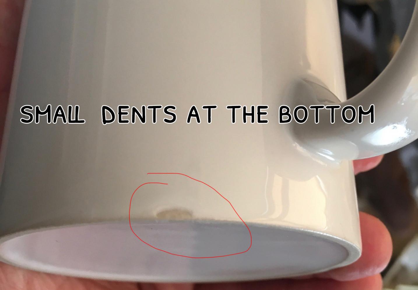

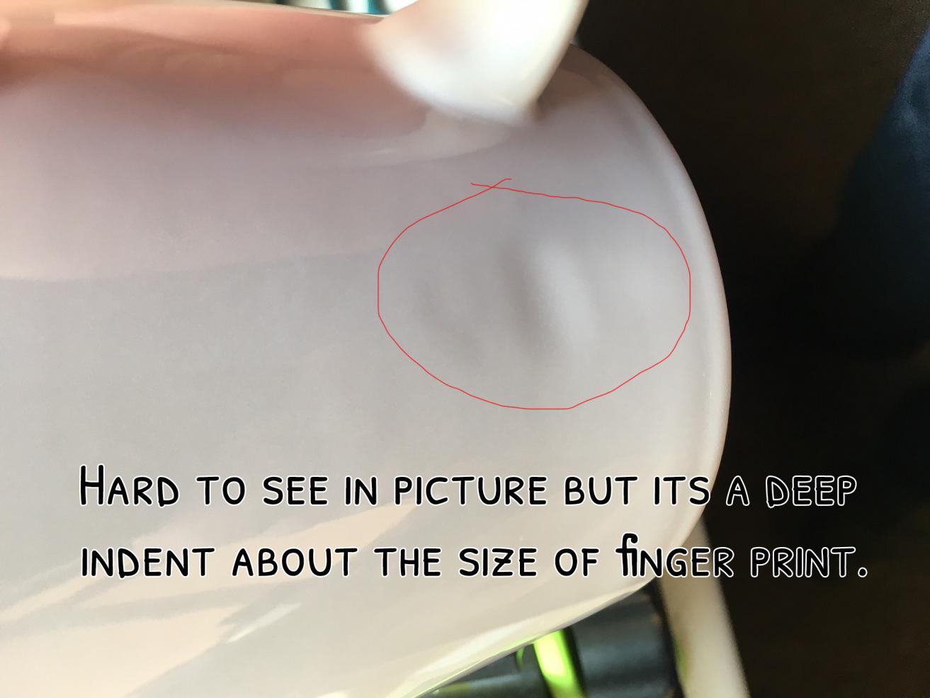

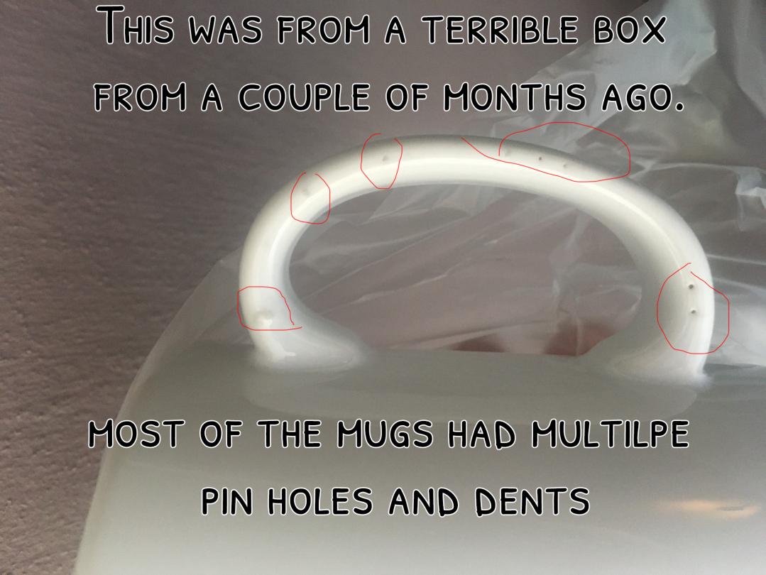

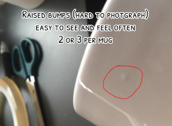

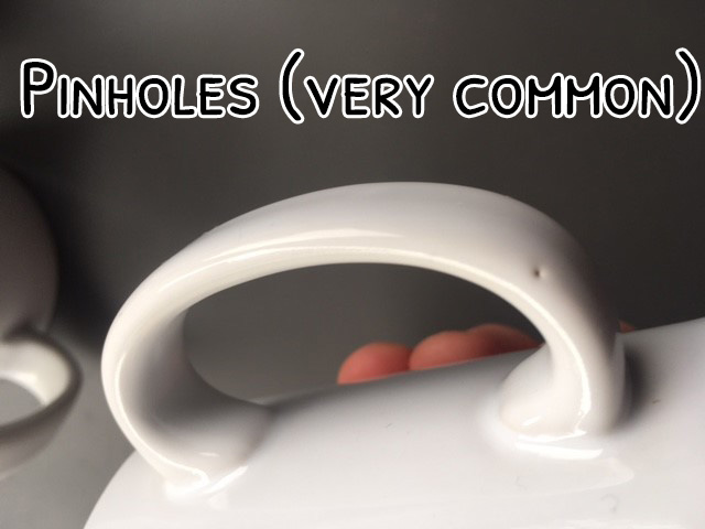

Here's a few pictures of typical rejects where quite small imperfections made them unusable for me. Most are pinholes and weird dent/chips
[ATTACH=CONFIG]6926[/ATTACH][ATTACH=CONFIG]6928[/ATTACH][ATTACH=CONFIG]6929[/ATTACH][ATTACH=CONFIG]6930[/ATTACH][ATTACH=CONFIG]6927[/ATTACH]
Do these look like typical small things that most of you would just use or I am being too picky?

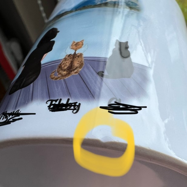

here's an example of a picture a customer sent me asking for a new mug to be sent it was a very small chip in the bottom of this one
[ATTACH=CONFIG]6931[/ATTACH]
