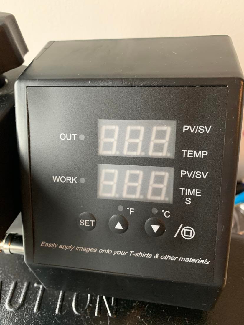

Just pressing coasters, key chains and car coasters initially. There are no instructions on how to set the temp, time etc. I've managed to figure out partly, but the timer isn't counting down, so doing something wrong.

There should be a button on the unit to start the timer.
So you would close the press after it has reached temperature and press the button to start the timer.
post a picture of the control unit and we can advise further.

Re: Crenex 5 in 1
[ATTACH=CONFIG]7027[/ATTACH]
Here's a photo of the control unit.
- vB_ID:7027
- 311920094_637403987979576_6838905895707183669_n.jpg (95.3 KiB) Viewed 268 times
Re: Crenex 5 in 1
If it is like most other controllers-
Press the set button - the temp should start flashing
Adjust temp with the arrows
Press the set button again and the time should start flashing
Adjust time
Press set button and both time and temp should be set.
If you only want to adjust one or the orher setting you still have to go through the whole process. Basically keep pressing the set button until everything stops flashing.
Adjust time
