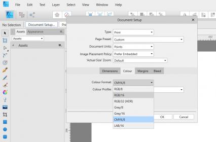

How would I even know that? It’s a logo from Canvapw66;151559 wrote:Is your source artwork saved as CMYK? It needs to be RGB before you print.
Re: Incorrect Colours
In Affinity click on the 'Document setup' tab and in the pop-up click on the colour tab. Make sure one of the RGB options is selected.
[ATTACH=CONFIG]7028[/ATTACH]
- vB_ID:7028
- Screenshot (75).jpg (14.38 KiB) Viewed 359 times

I have just checked that and its RGB/8 stillpw66;151561 wrote:In Affinity click on the 'Document setup' tab and in the pop-up click on the colour tab. Make sure one of the RGB options is selected.
