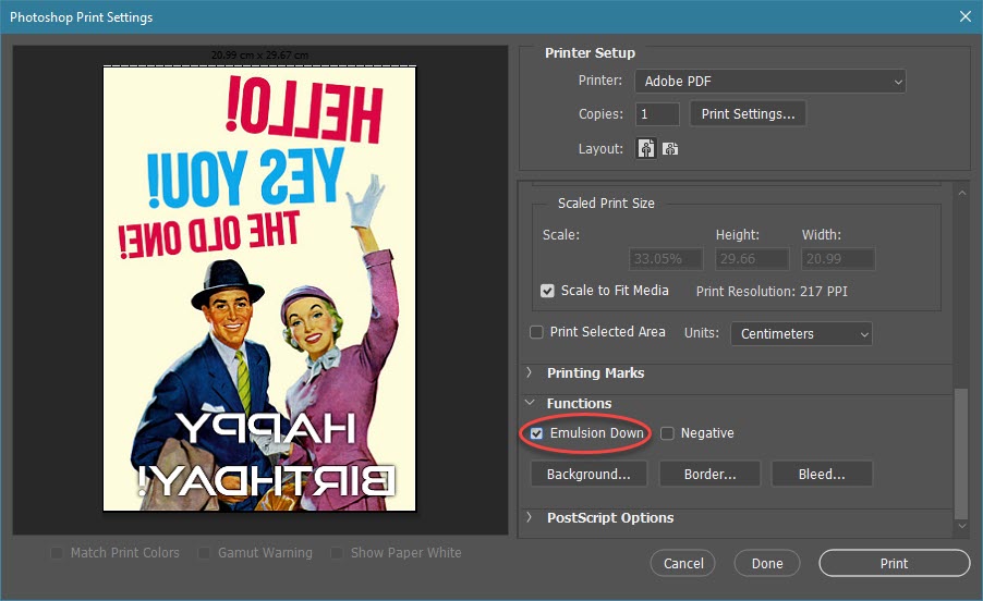

nath69uk;152484 wrote:Whats the alternative?
I'm only using it as it has the auto mirror function.
What do you use for your design software? Most allow mirroring. For example, in Photoshop you simply select 'Emulsion Down' when printing.
[ATTACH=CONFIG]7173[/ATTACH]
