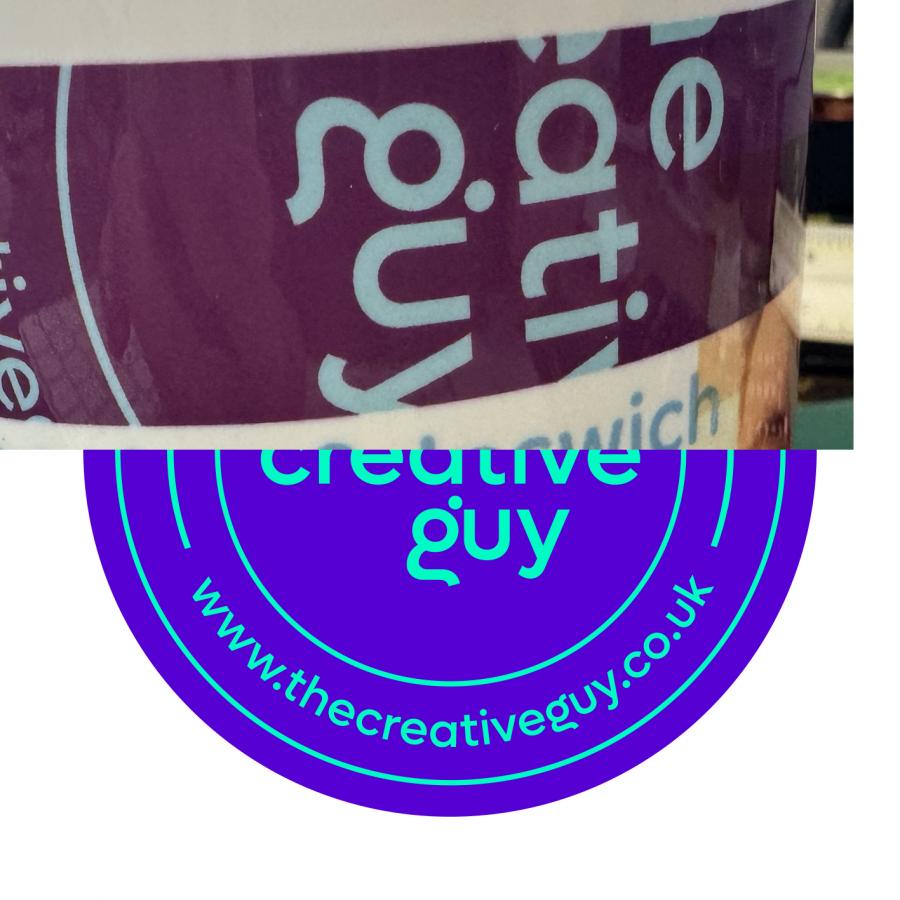

Looks good, out of interest, were your purples set to be that colour or were they punchier on screen, only reason I ask is because I'm trying to sublimate a purple and aqua blue. With an Epson F100, and they're coming out awful... top being the sublimated print, bottom being the one screen colours.
[ATTACH=CONFIG]7340[/ATTACH]
vB_ID:7340
vB_ID:7340
sample print.jpg (79.36 KiB) Viewed 1638 times

Print out was exactly what we saw on screen. We stayed away from F100 for that reason based on feedback from others and I believe you cannot use a custom ICC either.
