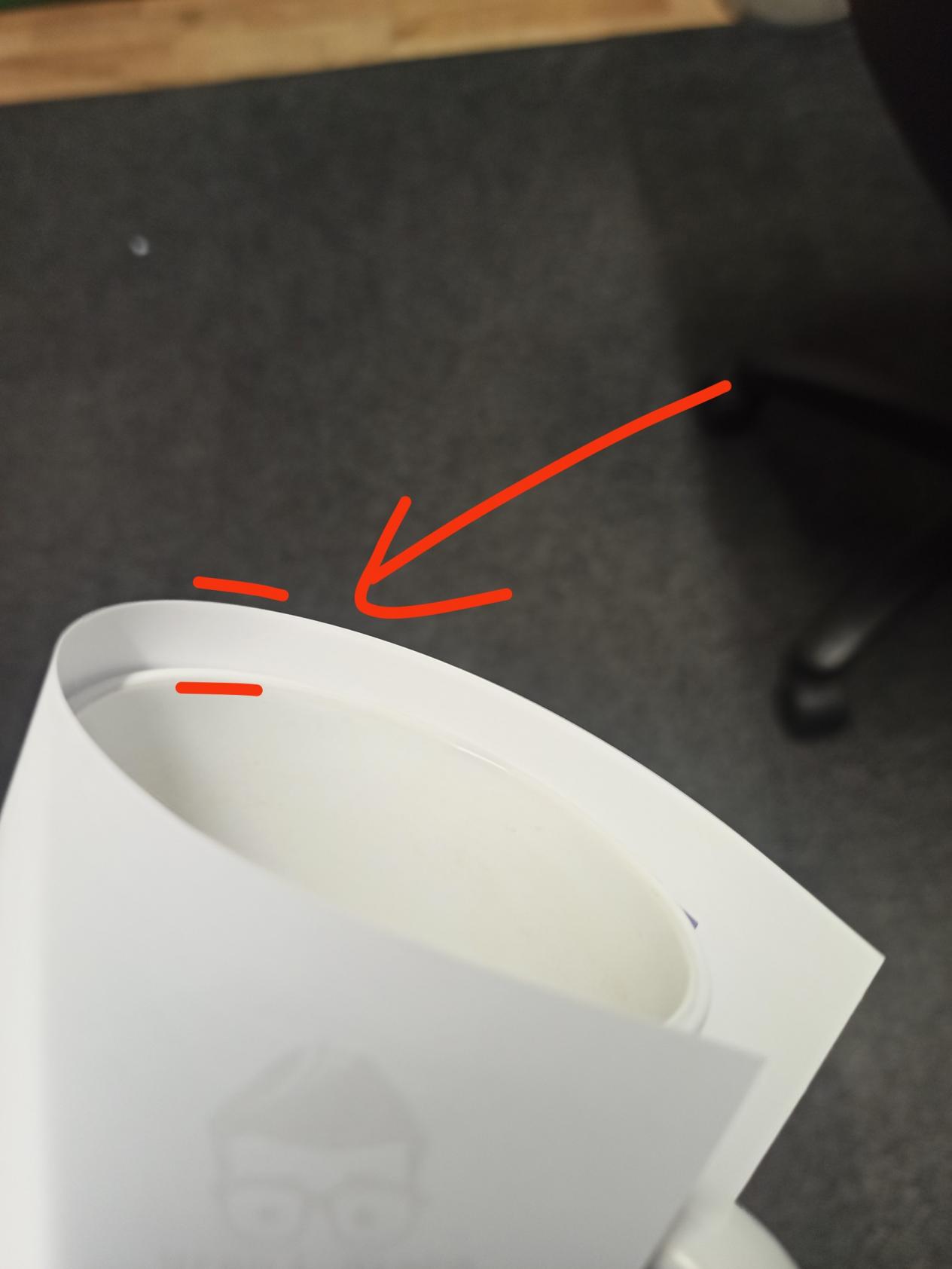

We used to run a couple of A4 Epsons solely for mug sheet sized paper. Never had any feed issues but as they were 4 colour I was never happy with the output. Reverted back to my trusty 1500W's and I have one happily churning out mug sheets as I sit typing this :-)

I gave up on mug sheets because my 120 gsm paper was always curling and catching on my L805s. So even a spec of black ink was finding its way onto the edge of a mug. Always having to keep a close eye on the straighness too.
I do have an almost retired 1500 sitting here. What mug paper are you using Justin?

We're using the Versa pre-cut paper. I did have an issue with the edge catching at the start so we use the slightly taller paper, that way if it does catch it doesn't print onto the mug.....the top 10mm or so sticking out above the mug.
[ATTACH=CONFIG]7407[/ATTACH]

So you are feeding the paper in horizontally too. That might help with alignment.

Yes, it only works horizontally.
