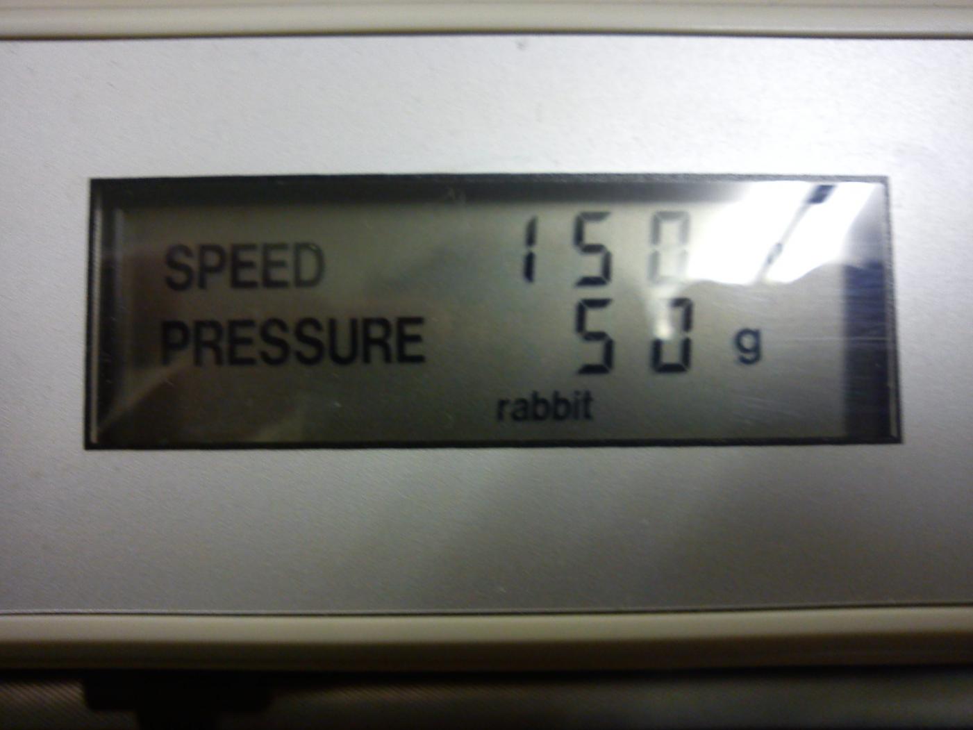

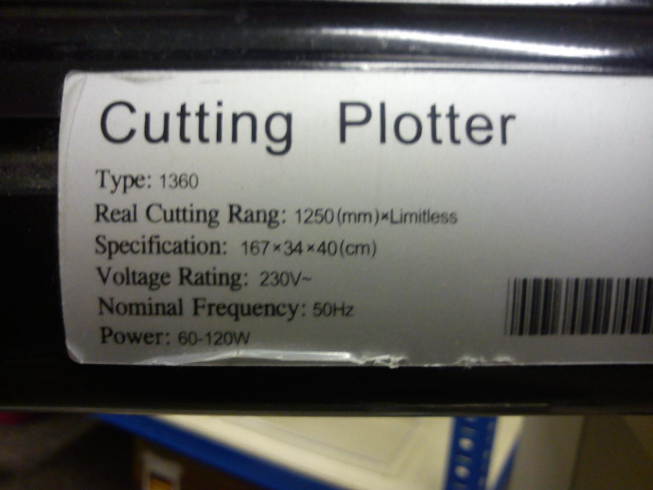

just bought a 53" cutter from a guy but didn't come with driver
It has on screen rabbit and on back the number says 1360 after googling i think it's a HX1360 rabbit cutter but i can't find the driver
Can anyone help i've attached some pics

Re: Rabbit cutter help
Which software package are you using for cutting?
If you have FlexiPro, you shouold find the driver in there.
You could try contacting the manufacturers for the driver, if googling for it fails
Just found this, does it help?
http://aspgfx.com/download/rabbit+hx-13 ... +free.html
I clicked the first link and it wanted to install the required driver, afaik
Kaz;15945 wrote:Which software package are you using for cutting?
http://rabbitlaser.en.made-in-china.com ... 1360-.html
Hi Kaz
I'm going to use Artcut 2009 if i can, i've just sent company email to see if i can get driver if not i'm just gonna sell it can't be chewed with it
