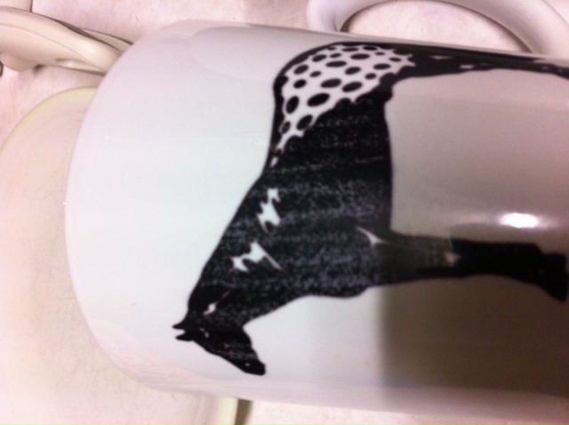

as title says, what causes these white rough lines on the image, too much heat, too less. They seem to fit in with the burn marks left on the sub paper
[ATTACH=CONFIG]364[/ATTACH]

ok, I think I have solved the problem, I set the temp now to 150c and 3 minutes, they are coming out much

Just for future information, it was probably paper sticking to the coating - a by product of too much heat or pressure.
Re: what causes this
150c???? try 180c for 3min.
