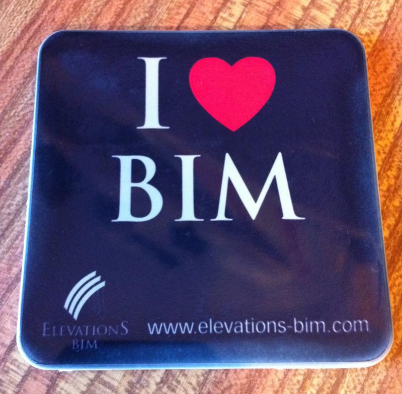

Here's the best I've managed to get it so far:
[ATTACH=CONFIG]601[/ATTACH]
vB_ID:601
vB_ID:601

Have the got a film on, just use you nail and feel along the edge sometimes and peel back

It's a normal flat bed press, Ricoh 3300 printer with gel ink. Medium pressure. There is no plastic covering on the coasters. I use the colour profile that goes with the printer - it's not sure much that the colour is off, it's just not even.

I've tried heavier pressure, longer time and higher heat - ended up nearly melting one. I think I might have to send them back.

as far i know (not try myself) but gelink need far less heat then standard sub ink... if you got few spare try much lower temp. something like 180C for 90sec. print smaller picture so you can try same coaster more then once. :wink:
