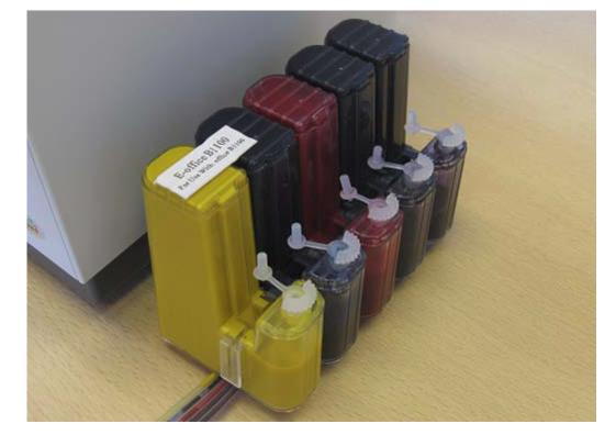

you need to take them out and replace with air filters. have you done that?

They are set up as in the attached picture - borrowed from the manual! The main bit is in place with the middle section pulled out.

Re: Epson B1100 - Constant Blockages!!
thats fine then. wasn't sure if there is air going in :)
