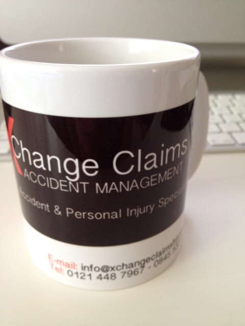

New to mug printing some assistance! blacks not looking like black!
Re: New to mug printing some assistance! blacks not looking like black!
We use a 3300. preheat press with dud mug in till press is up to temp as justin said then try press at 180 for 180, make sure when you put print mug in the press is tight .

Question silly one I think but i will ask lol Shall I preheat the mug at 180/180 too?
i usually just leave my mugs ontop of a heater just to warm it a little.
you start preheating for 180/180 i'd love to watch you try putting the transfer paper on
you'll be having some serious burnt fingers.
some items you pre-heat a bit just to take moisture out, make sure it's flat etc
but you only do it for 10-20 secs
Hey guys, I managed to pre heat and followed your excellent advice...and it worked!
the white lines/streaks ! thank you
