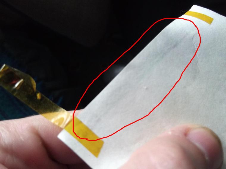

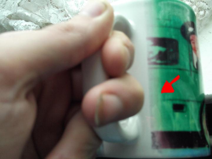

Hi, i am using a epson s22 that is using refillable ink cartridges that have been topped up with sublimation ink. I have got the sublimation paper, 11oz mugs and the mug press. I print out my mug image mirrored on the sticky sife of the sublimation then after its dried, i tape it round the mug with the heat resistant tape. My heat setting is 200 and the seconds setting is 135 secs. After removing the mug when the timer has beeped, i stand it on my windowsill to cool down. There is always a grey mark on the paper on the right hand side of the handle, near the end of the image. I dont know why this is happening but when i remove the paper from around the mug, it seems to of affected the image that has gone onto the cup and that area will either have faded colour or not been transferred onto the mug correctly. As for the other end of the image, that tends to fade out slightly on the edge. I have no idea what puts that grey mark on the one end of the image or why colours fade/dont transfer properly. The red sections tend to be very vibrant and like a neon colour which sometimes bleeds into surrounding yellow parts. I have got rid of a lot of mugs trying different things so can someone who uses this printer or something, tell me what settings my epson s22 needs to be set to or if theres certain precautions/things i need to do? Ive noticed some people leave a little white border around their image when it comes to cutting it out. Thanks for any advice you can give me.

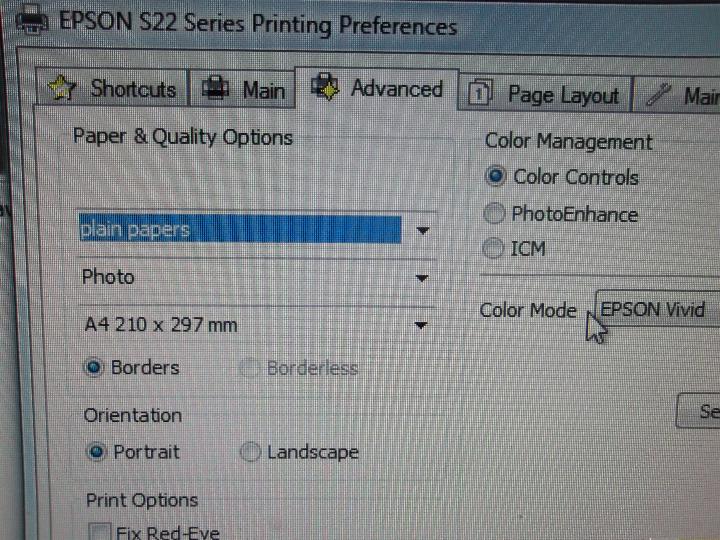

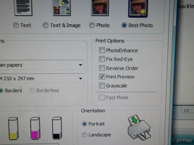

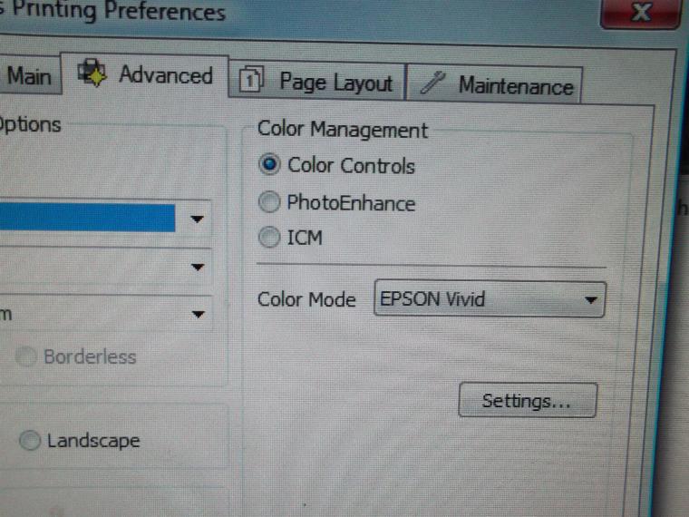

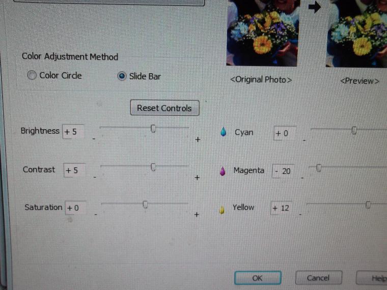

[ATTACH=CONFIG]1117[/ATTACH][ATTACH=CONFIG]1118[/ATTACH][ATTACH=CONFIG]1119[/ATTACH][ATTACH=CONFIG]1120[/ATTACH][ATTACH=CONFIG]1121[/ATTACH][ATTACH=CONFIG]1122[/ATTACH] sorry for taking a while to reply. it was saying my image size was too large. Ive included pics of my current Epson s22 printer settings, and a photo of the finished mug/grey line on the sublimation paper. Thank you.

OK. Immediate problems I can see.....You're trying to print too close to the handle hence the fade out. I tend to print 200mm x 90mm on a 10oz mug. Next problem. I'm now assuming you have no profile set up as your printer settings are wrong. Colour controls should all be off and ICM selected but only if you have profile installed.
With no profile you won't get a decent reproduction...with the wrong profile it won't be much better!
I can't really see the gray mark on the photo. What make of paper are you using and whose mugs?
Head over to the Sawgrass Europe website and follow setup instructions for a different 4 colour printer. Then, you need to set up your software as well.....instruction on Sawgrass site.
You can't make your own profile unless you have the equipment. I use a ColorMunki which works very well...member Paul has a more sophisticated setup and can do them via the post for you.

Justin is right! you need to switch ICM off. then you will be able to print via ICC profile.
