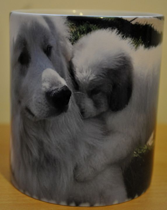

Do you mean like this ??
[ATTACH=CONFIG]1195[/ATTACH]
I use mug clamps and an oven.. and this was one of the mugs I tried a full wrap on.. it didn't work, so never done it again lol..

WorthDoingRight
Posts: 1126
Joined: 23 May 2012, 08:36
Re: Removing fading/feathering from edge of image
Post by WorthDoingRight »
Well I personally do not think that fading detracts too much from the design (although it isnt right)

Post by Andrew »
It would largely be the mug that causes the problem with the last 5mm or so of the base tapering inward. Not too many mugs have a good enough base to print full top to bottom so it becomes trial and error as to which you can do this with. Pressure placed on the mug needs to be slightly more as well if you are trying to get a full top to bottom print. Which mug are you using for the problem prints?

Andrew;54020 wrote:It would largely be the mug that causes the problem with the last 5mm or so of the base tapering inward. Not too many mugs have a good enough base to print full top to bottom so it becomes trial and error as to which you can do this with. Pressure placed on the mug needs to be slightly more as well if you are trying to get a full top to bottom print. Which mug are you using for the problem prints?
although id agree to a point with this its not the main cause , i have always used bms mugs i have a cheap press which i use for water bottles and a not so cheap press for my mugs which i get perfect top to bottom prints every time however if i use the cheap press i get the same issue as the picture in rennio's post same mugs differnt presses differnt results ergo its the press at fault

I would go for that as being the secondary cause in my book hence why I mentioned additional pressure to try and overcome the mug taper. If the mug isn't tapered at the base in the first place then there wouldn't be the problem to overcome. Whether you can overcome this is then down to the press. Just my opinion in having been through so many different mug options.
The straightest mug we have printed did in turn cause it's own printing issues so it is never straight forward. The way in which the kept it straight to the bottom was to place more ceramic into the base which then absorbed more heat than the rest of the body leaving it pale. Many different scenarios occur with different mug and press combos. Flaming is largely down to the mug.
