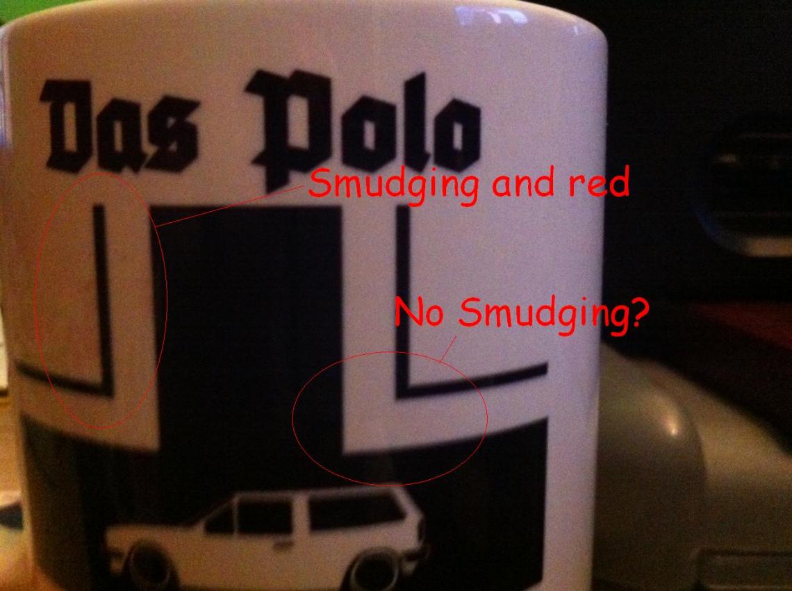

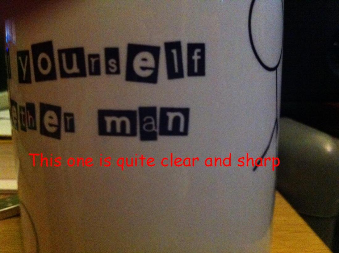

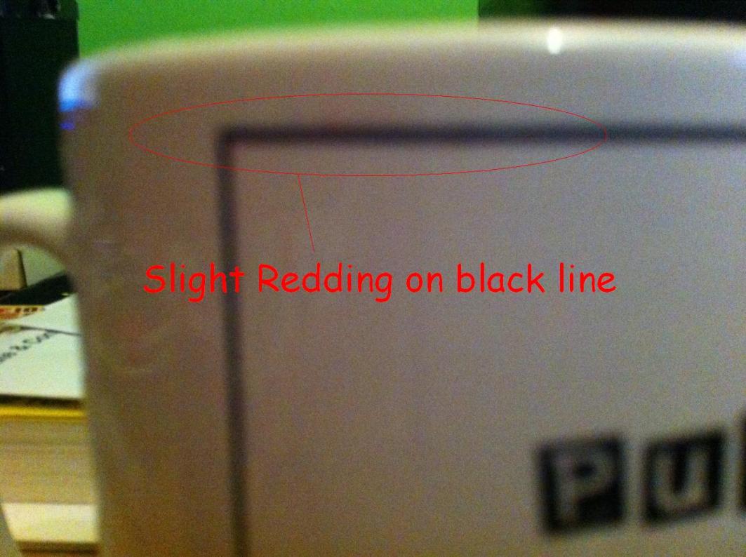

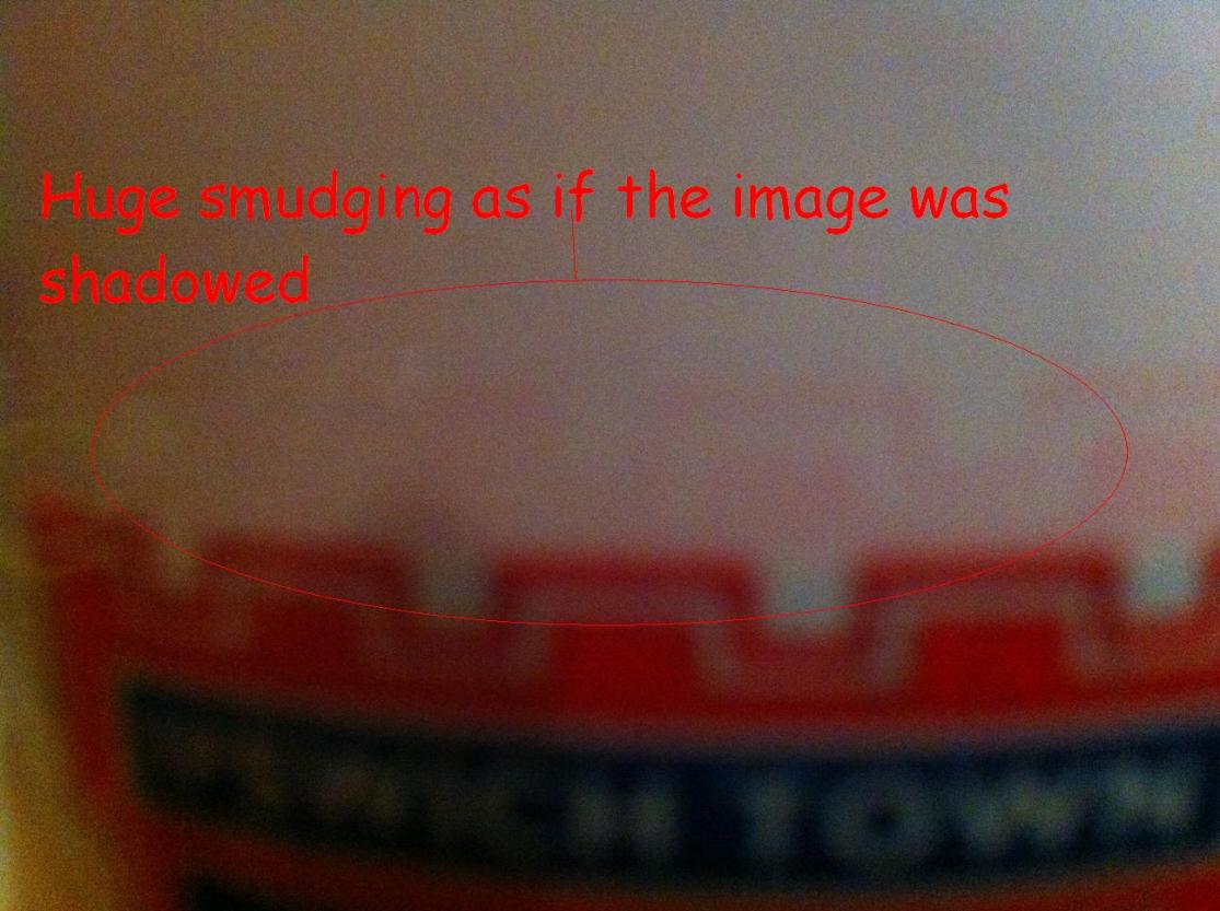

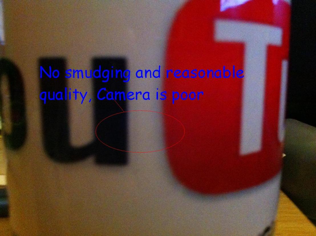

Hello again, thought i would add some pictures of the good, bad and terrible that I have produced, no of which I would be happy to sell, just in case this helps with any advise.

Fuzzing is normally due to over 'cooking' your mugs, after a point, the ink will bleed, try shorter times.
I started with a cheap epson setup, maybe you can learn the tricks with what you have,or maybe you should just spend the money and get a good setup......

i have the same stup possibly from the same seller but dont have the redness issue, the redness could be due to pixelation your design as its around the lines mainly, also try having your press a bit tighter lastly if your mug is taking the ink whilst your trying to line up the print the mug is probably too hot at this point as it is most likely the heat that is releasing the ink, all i do is print my image, cut it with a paper guillotine while press is reaching correct temp, i put my print on the mug with heat tape whilst cold and put it in the press so that the blanket is slightly compressed by the mug whilst fastened and set the time for 3 mins, peel straight away and put the mug in luke warm water so it cools down they seem to turn out fine this way the only problem i tend to have is the colours but that is down to the printer, i need a decent profile as the colours never come out right on standard settings either too blue/green or really yellow, i have mine set as yellow -3 and cyan -2 this seems to give me by best colour match on subliprint d88 profile this is all probably wrong by the way but works for me

Change paper is what i would do first. look like you have some high release paper that dont dry.
Buy express economy paper or bit more expensive truepix or texprint. this should help you a lot. Also change pressure from firm to medium. enough to keep mug not moving... to much pressure also make blurry images!
