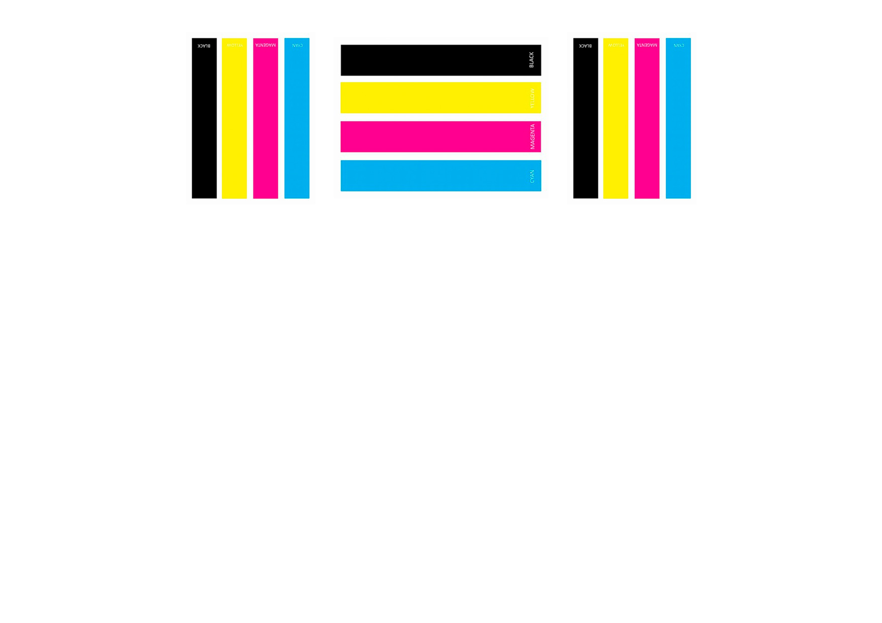

I run this through my b1100 (a 4 colour print as the b1100 is a 4 ink system):
[ATTACH=CONFIG]1626[/ATTACH]

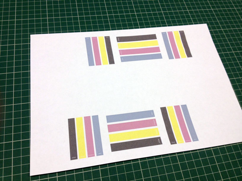

and I always get a clear print (print out may look faded as I'm printing with my profile onto plain paper):
[ATTACH=CONFIG]1627[/ATTACH]
So, a little investment in preparation and looking after your equipment will help in the long-run :)
