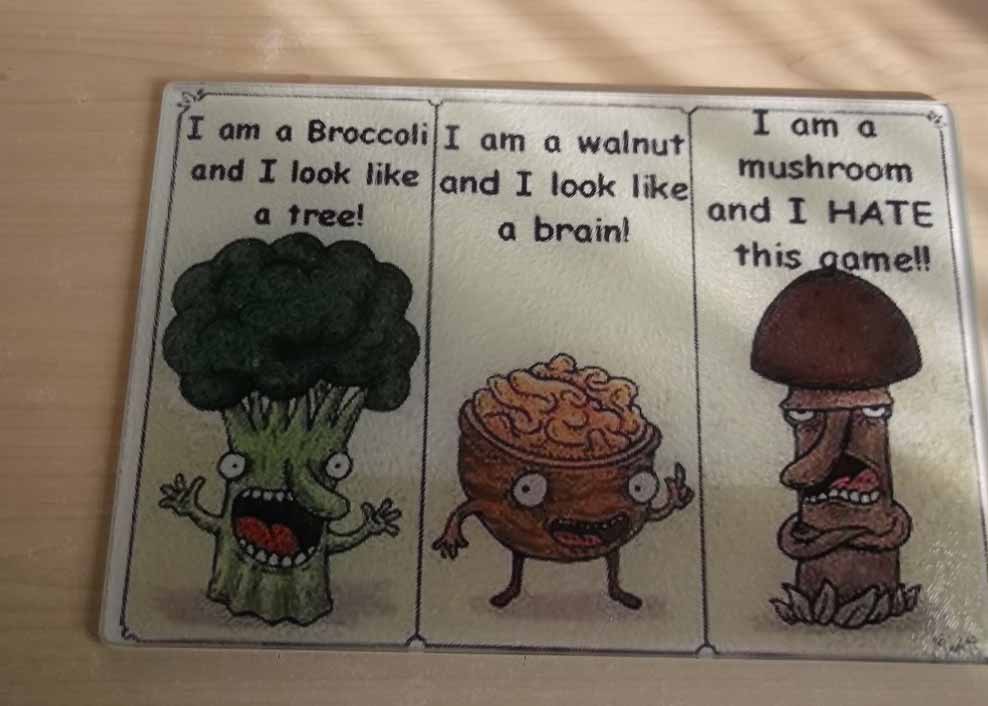

I ordered one (thetransferpress) for myself, and im quite impressed with the way it came out. (see pic)
Temp 200 time 4 mins med pressure
As per transfer press instuctions
Pressing time 4 minutes at 200° c with medium pressure. Important - do not mirror image when printing out your transfer. Lay transfer on base of press and place the chopping board on top (white side down) covered with a sheet of plain paper.
(i covered with silicone sheet as well)
