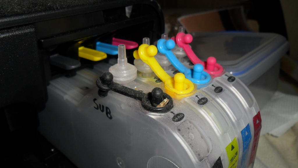

I'll add that I use a pair of Brother A3 printers (both are MFC-J6510DW) and they are cheap and reliable. Both run the same cartridges you got. With your cartridges will be a little bag with 4 funny clear round things each like a pair of tiny funnels joined together. These are air filters. I've added a pic that shows where they go because I completely forgot about them when I first started printing.

Those big cartridges get me hundreds of A4 size prints between fills. [ATTACH=CONFIG]2235[/ATTACH]
