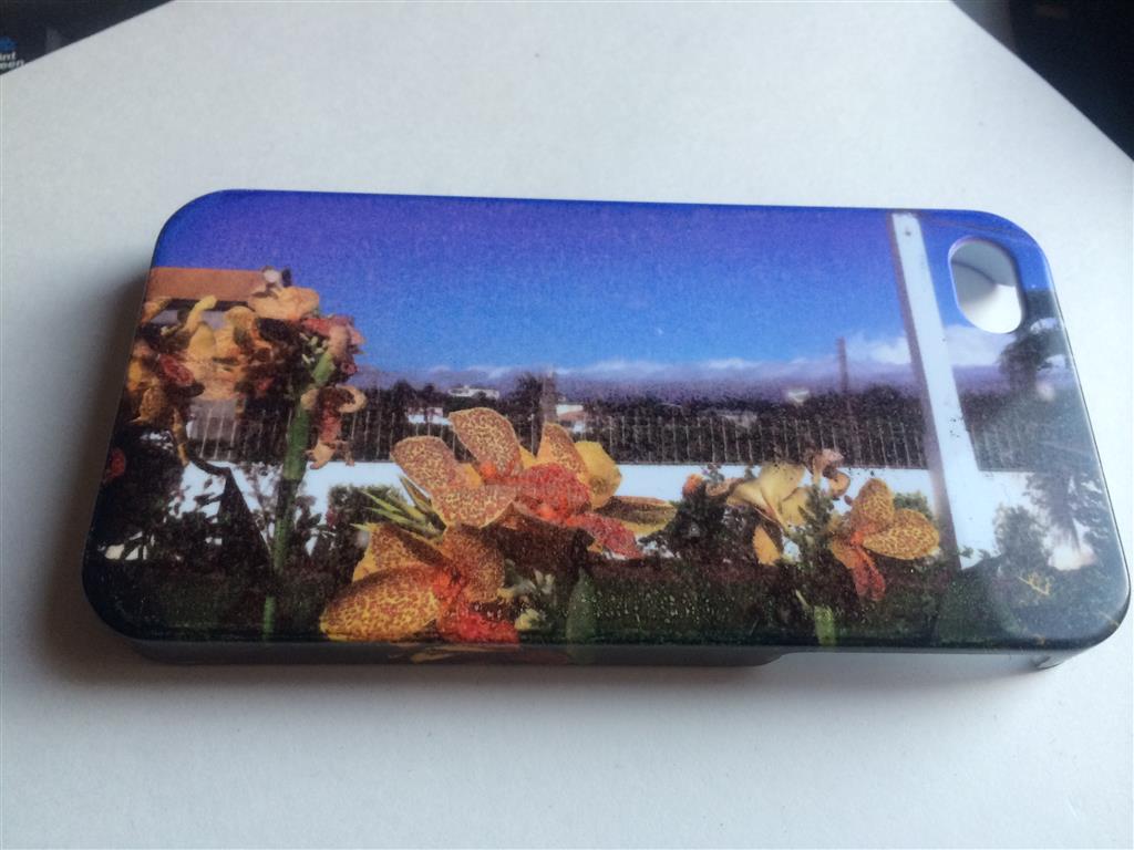

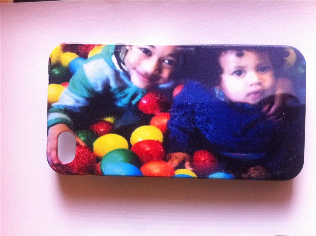

using paper supplied by microtec , ricoh printer sublijet-r & powerdiver
[ATTACH=CONFIG]2304[/ATTACH][ATTACH=CONFIG]2305[/ATTACH][ATTACH=CONFIG]2306[/ATTACH]

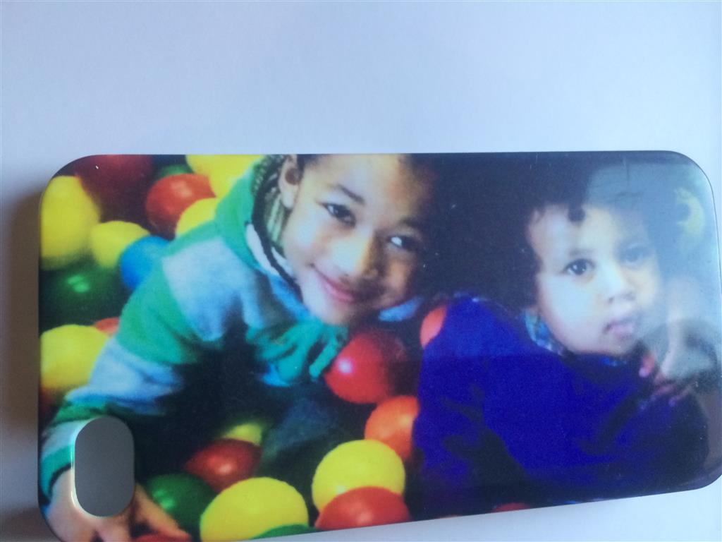

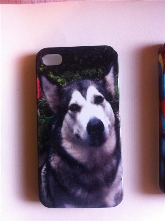

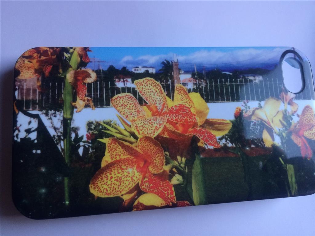

Using Trupix paper
[ATTACH=CONFIG]2307[/ATTACH][ATTACH=CONFIG]2308[/ATTACH]
and there not the best quality images i used for these cases but you cans see the difference in quality with the change of paper. I wonder if the settings/icc profile can be change to get better print using the cheaper paper? i'm happy with the trupix anyway

thats a hell of a difference, should only get better, i would keep using the better paper, dont bother with anything else,

This print definitely came out better. I think for the second case that you did with Microtec paper, you haven't let the ink dry on the paper, hence the grains.
In my country, there is no branded supplier of sublimation paper but as far as I know there are two types: one type does not absorb the ink (like the Microtec) and another absorbs the ink so it doesn't smudge after it gets printed. I've used both and I prefer the latter type since it doesn't smudge on the case and the difference in result is negligible.

g1njeremy;81380 wrote:This print definitely came out better. I think for the second case that you did with Microtec paper, you haven't let the ink dry on the paper, hence the grains.
Yes, you hit thenail on the head there, i noticed the ink didnt really dry on the microtec, kept smudging tried allsorts, after 20 mins still not dry . i dont know if there is a way to reduce the amount of ink it lays. Dried more or less straightaway with the trupix which i am going to stick with .
