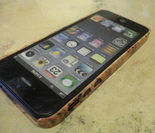

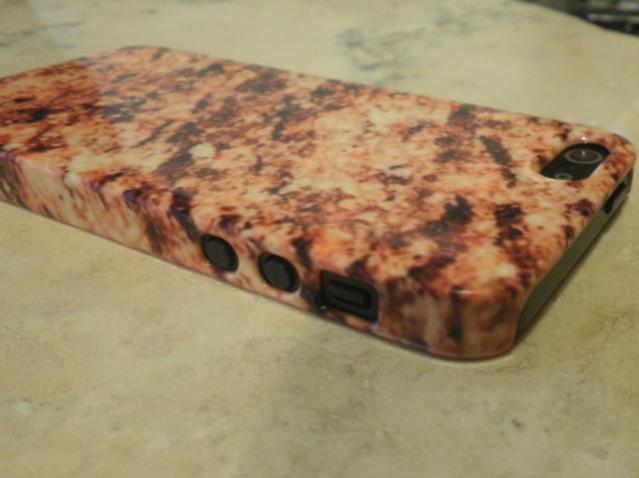

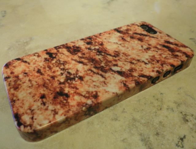

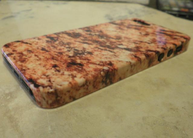

Attempted again today. Finally got good results using the above methods. Unfortunately, the heating element on my machine is now out so I have to order replacement parts for my machine. These machines are very low quality, mine has been falling apart slowly since the first week I had it.

Picking the right design as above makes your life a lot easier. Having said that, whenever we have had a go on the dark flat colours they have always printed well enough on the corners so not had a massive problems. There was a bit of folding/creasing going on but not a complex job.

It seems the more pressure from the vacuum, the better the corners turn out.
