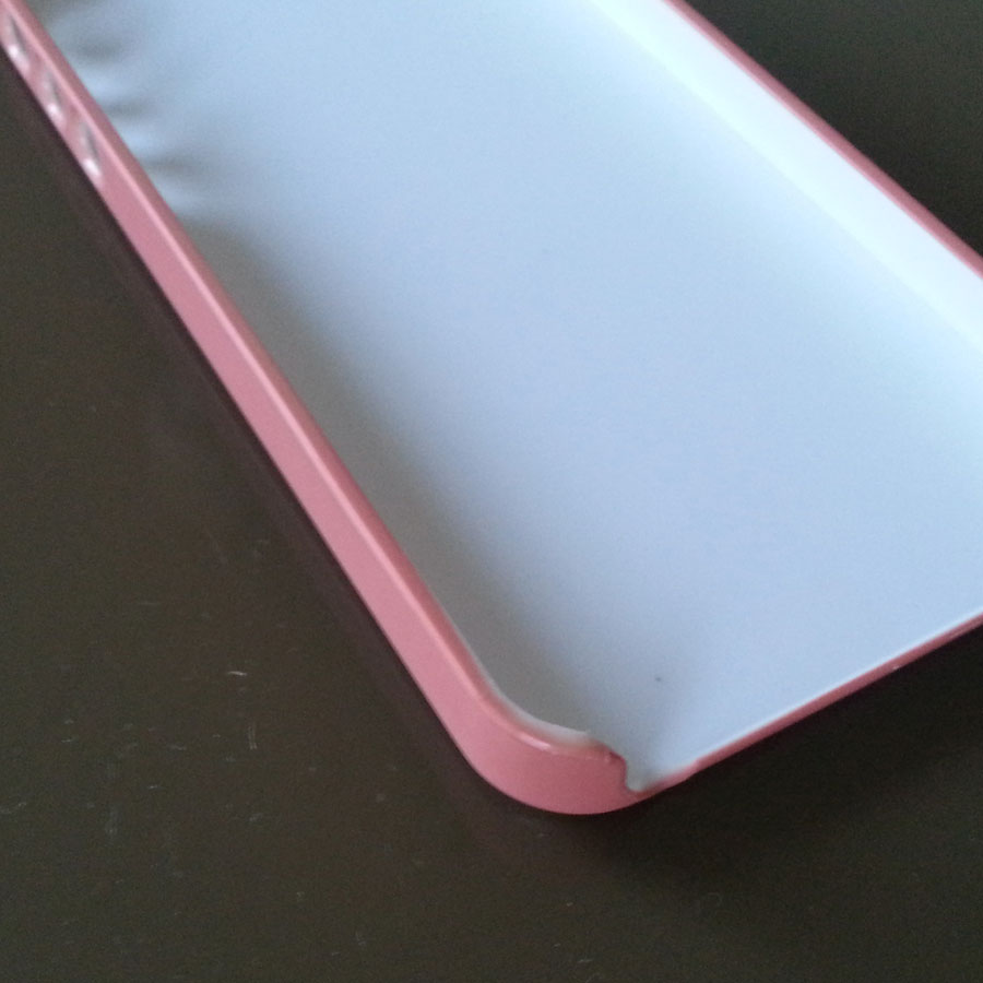

Hi everyone, I have now done some testing with my new 3d press (st3042). I've tried artygamers method but it doesn't quite work for me. The main issue I get is crease marks on the corners. Does anyone else get these marks with this method? Does anyone know if there is a way to solve it? Image below illustrates the issue:
[ATTACH=CONFIG]2917[/ATTACH]

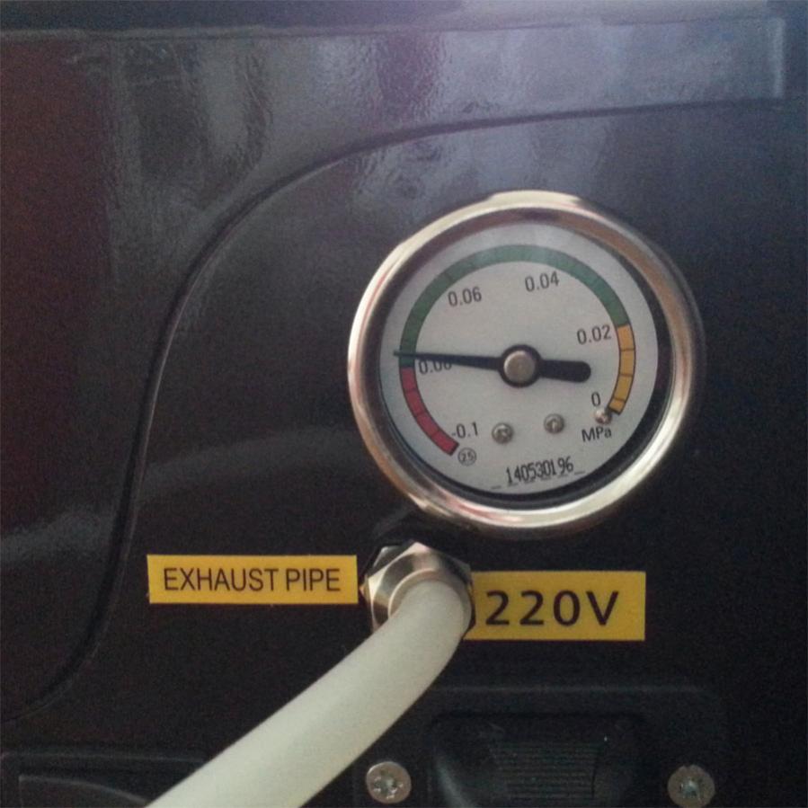

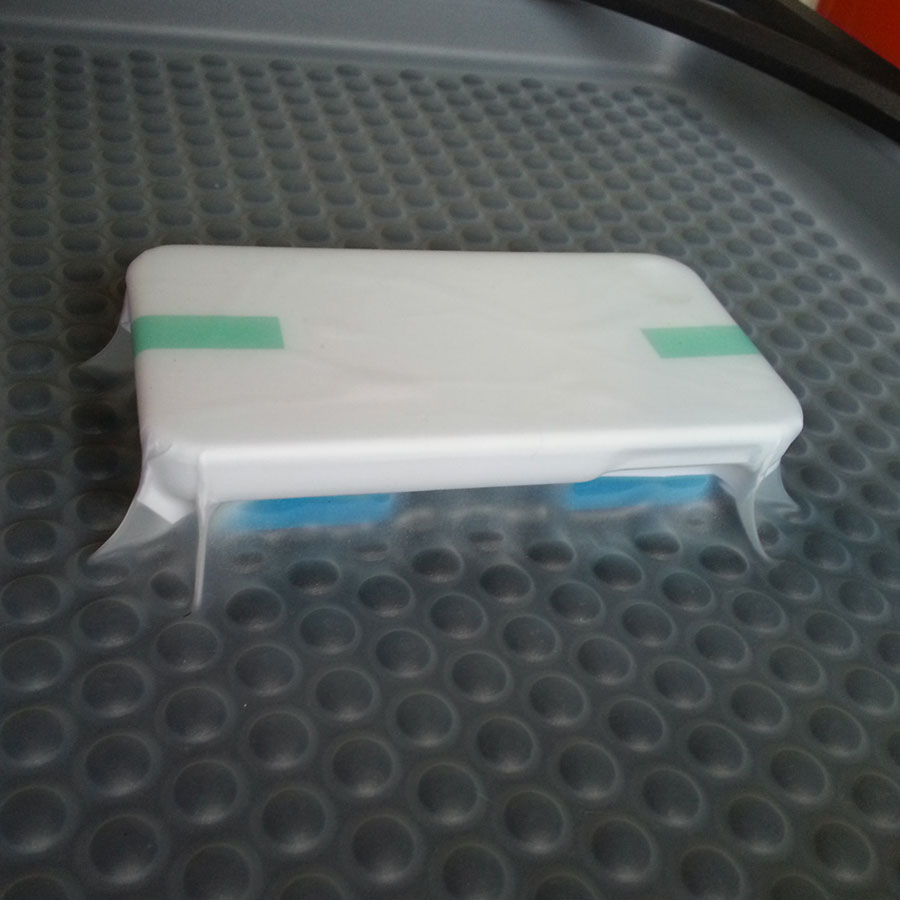

I've chosen a light solid colour for my tests to be able to see any corner issues. I also include images of what the case looks like in the press and the vaccum pressure I'm getting:
[ATTACH=CONFIG]2912[/ATTACH] [ATTACH=CONFIG]2913[/ATTACH]
The vacuum on my machine doesn't quite reach the red area. I've only used the machine a few times so I doubt there would be a split in the hose. Not sure what else it could be. Could also be that the dial is not 100% accurate and the pressure is more than it shows.

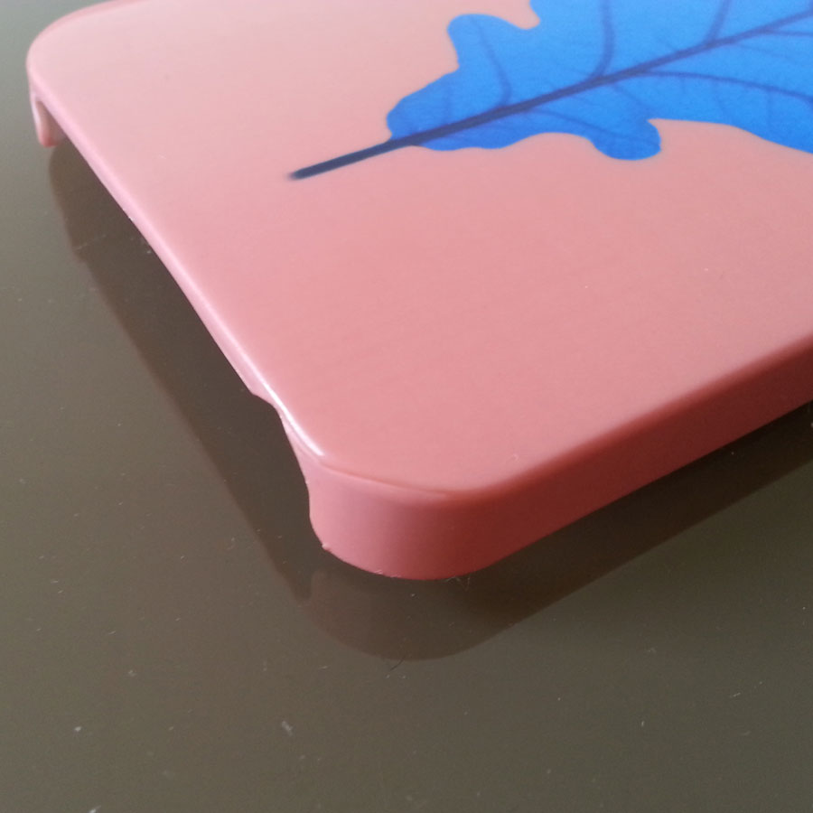

I've been getting better results with hand wrapping the cases, cutting the paper exactly to shape to avoid overspray on the inside. I still get crease marks but by hand wrapping I have control over where the marks appear and I only get one mark on each corner, see image:
[ATTACH=CONFIG]2918[/ATTACH]

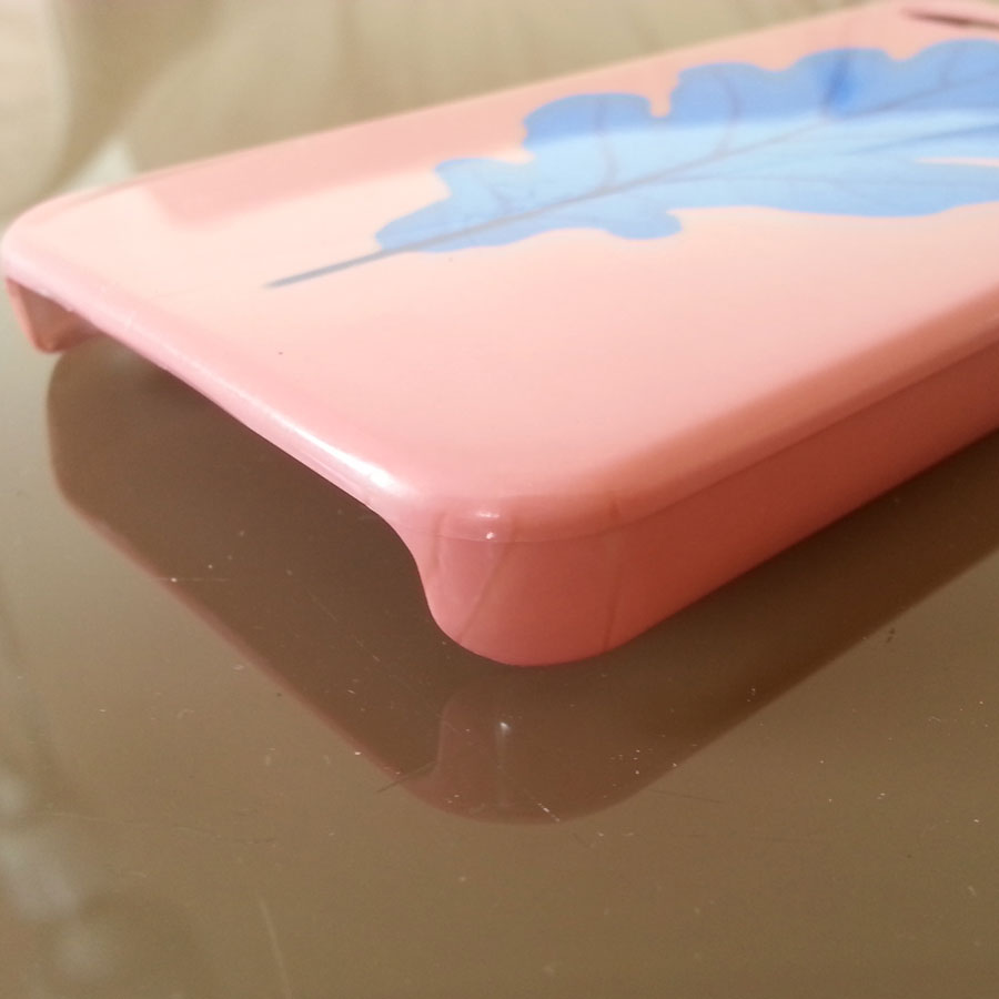

Regarding the top edges I got them to print ok with both artygamers method and by hand wrapping on the iphone 4 case which has a narrow edge. The iphone 5 cases I have are more tricky as the front edge is flat and wider. Below is the result on front edges with hand wrapping the iphone 5 case (results with the arty method were worse). I will need to tape the paper down on the 4 corners next time as there is some fading on the curves.
[ATTACH=CONFIG]2915[/ATTACH]
