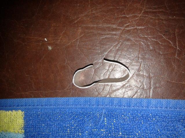

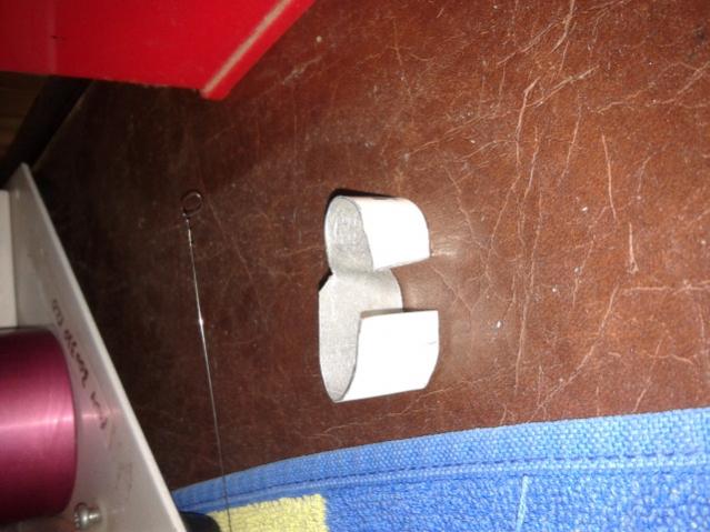

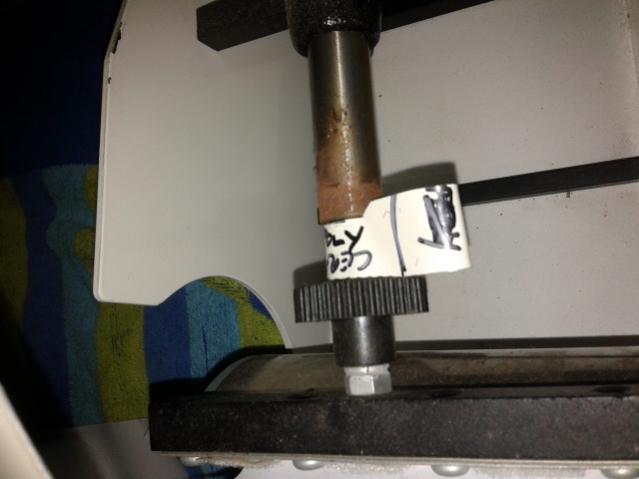

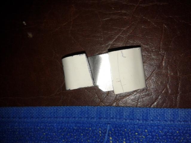

I use a similar idea made from a strip of thin aluminium (cut with scisors). One end is cut for ceramic mugs and the other for polysub mugs. I have another cut for the other brand of ceramic mugs I used, but mostly now I do do only one brand of Ceramic or else a poly.
I hang it on the thread from and tighten the screw wheel until it just touches.
Pressing the other type of mug is just a matter of flipping it over and adjusting it.
I've never shared it until I saw this post. I assumed everyone just did this
Anyway, it is a variation on the same idea.

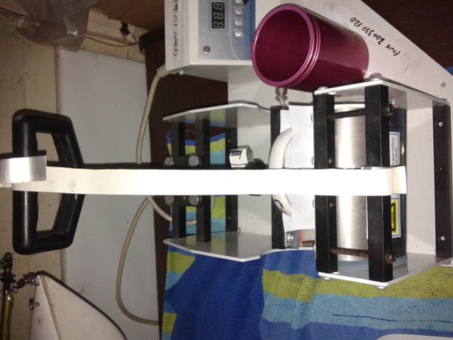

I also like to keep my mug pressed closed when it is heating or just sitting unused. But I don't like clamping it. I suppose the idea is left over from the old style heat element where it could lose shape if allowed to sit without a mug in it.
So here is the press with a strip of the same aluminium that clips over the press and the handle to hold the element against the spare safety mug. I leave it like that while it is heating for the first time of the day.
Probably unnecessary, but simple for those who like having a mug in place but don;t want to clamp. Like when I want to press poly mugs but my safety mug is ceramic size.[ATTACH=CONFIG]2948[/ATTACH][ATTACH=CONFIG]2949[/ATTACH][ATTACH=CONFIG]2950[/ATTACH][ATTACH=CONFIG]2951[/ATTACH][ATTACH=CONFIG]2952[/ATTACH]
