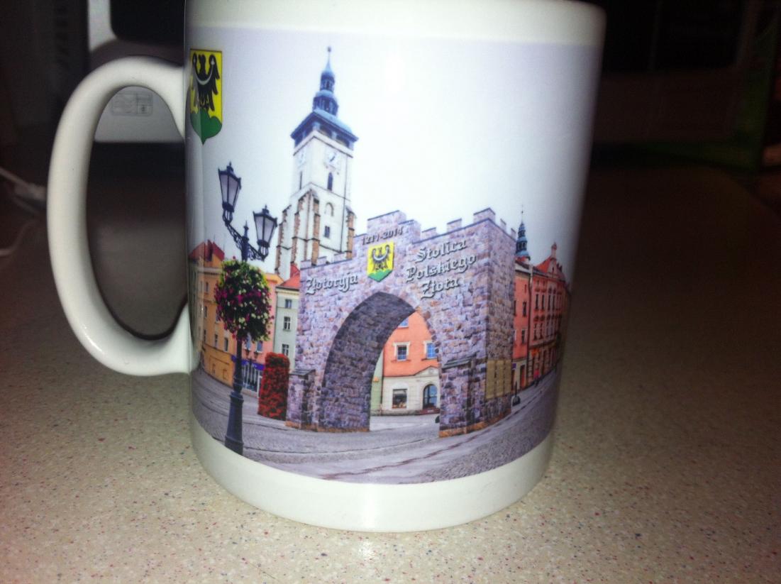

that's brill thank you Paul I will use the mug clamps, what temp and time did you use?
Re: New to 3D Mug Sublimation (Mini 3d sublimation machine)
here are the results.
http://www.dyesubforum.co.uk/vbforum/sh ... #post92303
i had it for 180C and 770sec. but people say this is to much :)

So I thought I would try 190C for 300sec in the mug clamp but it did not turn out well, the picture and text on the mug were faint. I will try your settings tomorrow Paul :-)

I'm like Paul 180 for 11 minutes 10s less than Paul :-)

i just tried 170C for 350 sec. Turn out ok ish. I started the count down as i would with my standard press, When temp stopped dropping. Just don't like sprees paper with my Ricoh and... This ricoh icc profile is winging me up!! :rolleyes:
