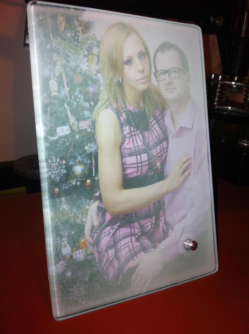

Re: Coralgraph glass photos
I bought some before christmas and had a go tonight. It look very cool and hardly anything can be seen through the glass. if you flip glass over the back is visible and quite vivid but not perfect. but through the glass - hardly any image as you can see below :/
Post by funkey monkey »
Don't mirror print your image because you are meant to look through the glass at the image and not the White sub side
@nash the first two I did with the image mirrored looked crap and dull, the ones I did after with the image not mirrored and looking at the image through the glass on the non White side came out perfect with the time upped to 240 seconds and firm presure, also the non printing side of the glass has a bevel edge.
i didn't mirror it and as you can see this is view through the glass and is pants. i used medium pressure for 300sec.
