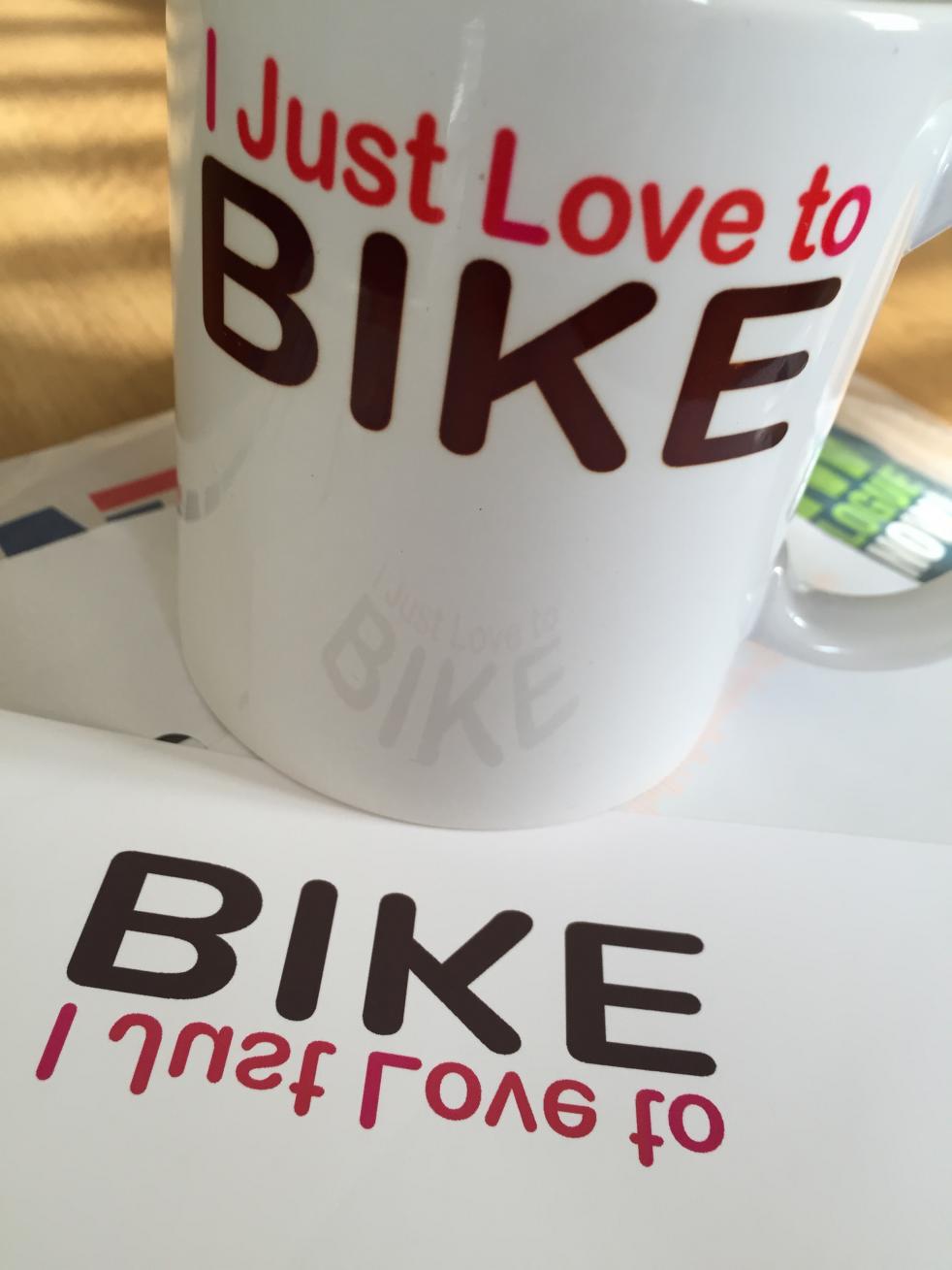

Now, the red text shades differ in colour. It's the same on paper. Some are red, some letters are pinky.
I'll attach a picture.

Yea I've noticed that reds seem to be problem colour, I'm using the Powerdriver with the Ricoh printer and I cannot seem to get reds to match print to screen, other colours and photos don't seem too bad. Reading previous posts a custom profile and the win driver maybe better but I've always managed to get something acceptble and I've never had a mug back

Try increasing your pressure a little I have mine so its not a struggle but the tension is noticeable this might help a little with the colours I don't know if its just the image but your black seems a little brown too a lot better than the first one though :)
Re: Dull finish on mug
If that is supposed to be black then take your temp down 10 degrees. Keep your time around the 180-240 seconds mark
Keep bringing them both down until you find that sweet spot.
