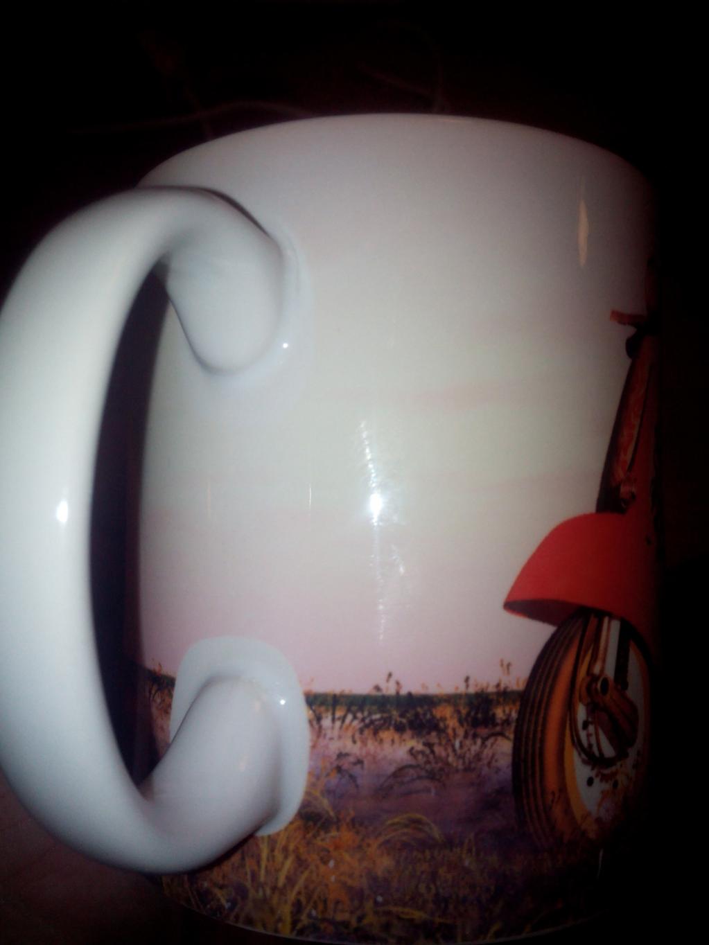

So I wanted to open this old tin of worms again :-) I know we'd all like to be able to print under the handle, or at least right up to it!

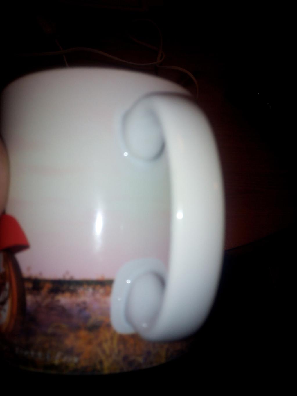

I have a mug here that I bought on holiday last year. Sublimation print that goes 360 degrees, under the handle with no obvious join. OK, I know , they're must be a join but I just can't see one. I'd 'assumed' this must have been printed before the handle went on but that wouldn't explain the gaps around the sections where the handle joins....and surely the coating at these points wouldn't be perfect?
I guess this still intrigues me....maybe even annoys me!
I saw this press a while back, whilst I can see it'd for products without handles it did start me wondering if this type of machine could start to shed any light.
http://www.sun-fly-sublimation.com/full ... c4-55.html
A press with 2 elements, coming together around the handle to meet in the middle....possible.
Also, there are patents where folk have tried to solves the issue, here for example...
http://www.google.com/patents/US5944931
Again, this might be an avenue worth pursuing but getting the transfer paper cut correctly and hiding a join sufficiently would be tricky.
Surely this can be solved? Just printing right up to the handle really shouldn't be that difficult....should it? The 3D machines and ovens print a fair bit nearer with wraps but still not close enough for me to be satisfied.

^Mrs. M......I agree, I just can't see how the handle could be applied afterwards. It's definitely a sublimation print as it's blurred ever so slightly at the bottom edge, they've mirrored the print to fit but I still can't see a join!
^JMugs.....Maybe there is a simple solution, I think the wrap may be the key, but getting the transfer right as well.

Checked all around the mug, only thing I can see is possibly a join under the handle, the background image is quite washed out/blurry which lends itself well to hiding the line :-) Still very well hidden if that's it though, and the paper must have overlapped a little.
