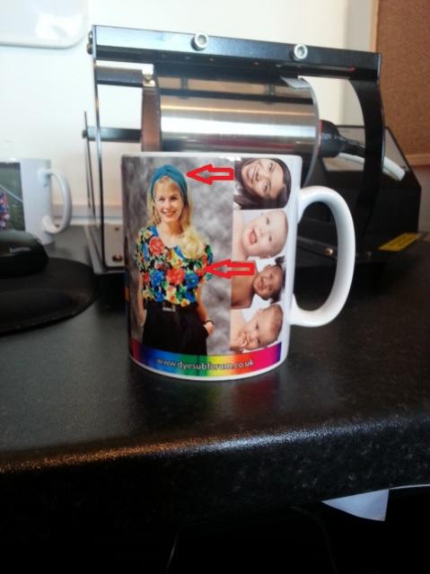

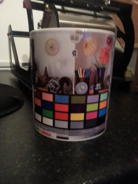

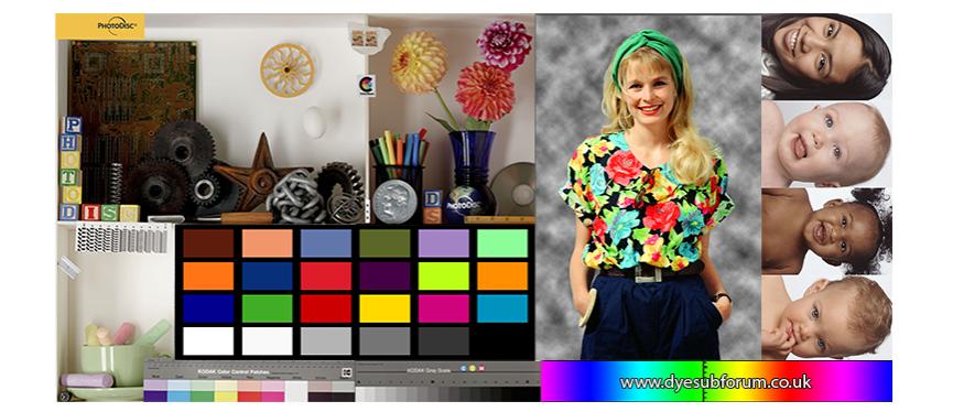

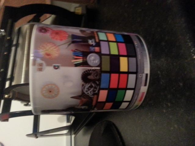

green cuming out blue
daddykev
Posts: 38
Joined: 06 Nov 2014, 06:36

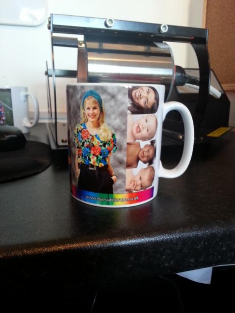

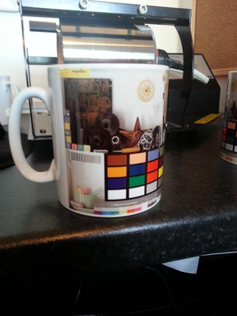

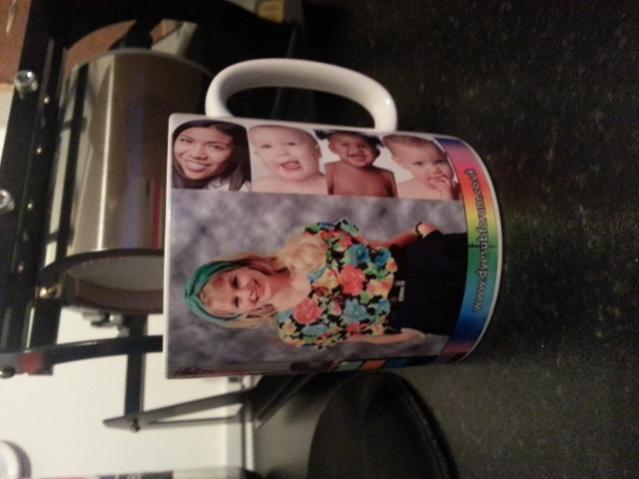

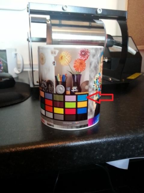

Re: green cuming out blue
Post by daddykev »
using
UKPress mp160 ebay
Ricoh 3110 package for listawood
Trupix paper from listawood
And mug are durham from listawood
photoshop cs2
temperature to 180 degrees and 180 seconds
vB_ID:3238
vB_ID:3238
testpattern (1).jpg (59.49 KiB) Viewed 579 times

That's a crazy mixed up profile. I know it does not help much but the skin tones look good and I prefer her in blue.
The yellow and light green look good.

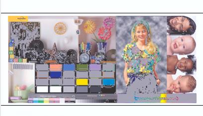

this is duo those colors are out of gamut in sublimation profile.
look at this picture. All grey areas are out of gamut. and if your photoshop is set to perceptual then it will "try" to find nearest color that can be printed. You can try to print it on absolute colorimetric and see if it will be any better but i don't think it will much difference.

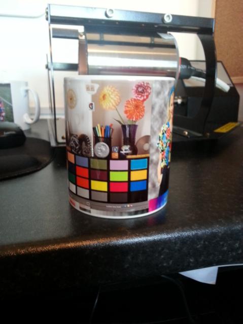

Yeaaaa that's better
daddykev
Posts: 38
Post by daddykev »

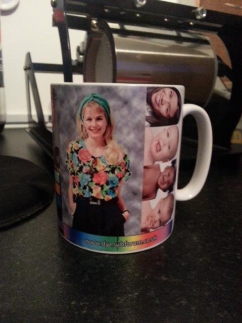

For any one how as the same problem it wast Setup TO: Photoshop PRINTING
GUIDE http://sawgrasseurope.indigofiles.com/t ... CS5_WP.pdf
PS. do you think its ok
so... your photoshop wasn't set correctly then?
daddykev
Posts: 38
Post by daddykev »
no Paul photoshop wasn't set correctly. what you think of my mug is it ok are yours better do you think i can do better? thanks for you help paul you have be a great help with in this form. one day you may get paid for helping people.:smile:
