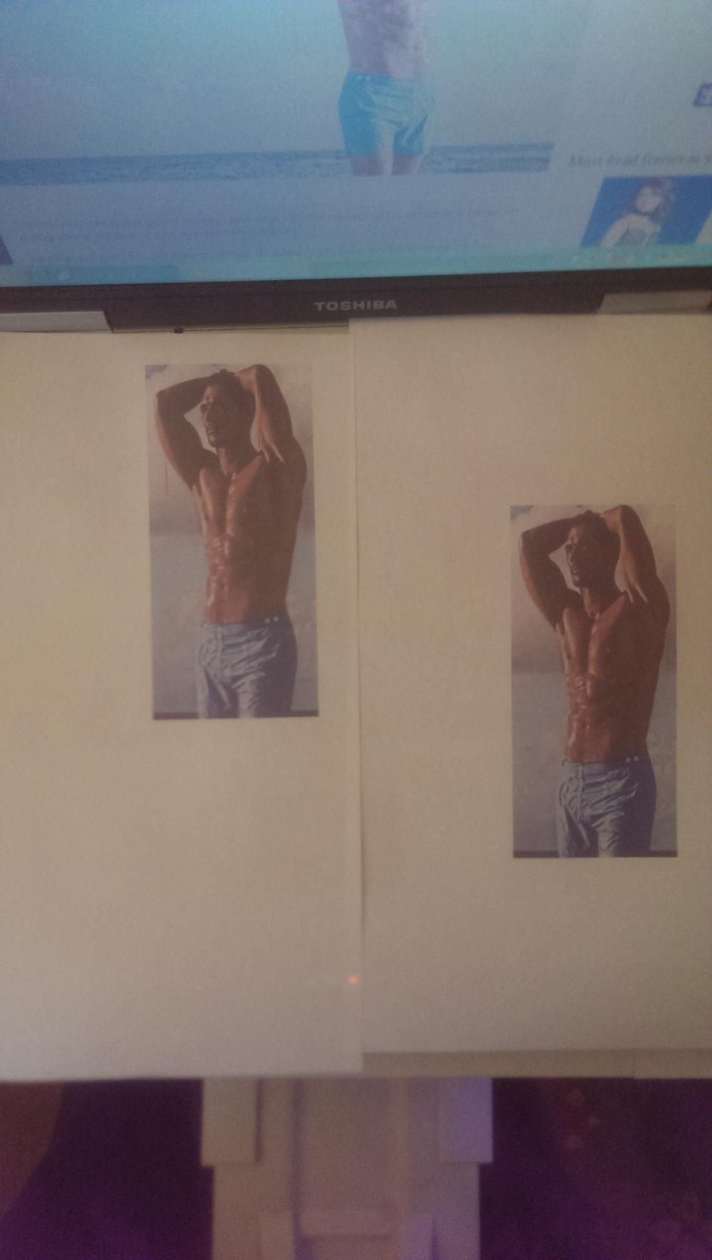

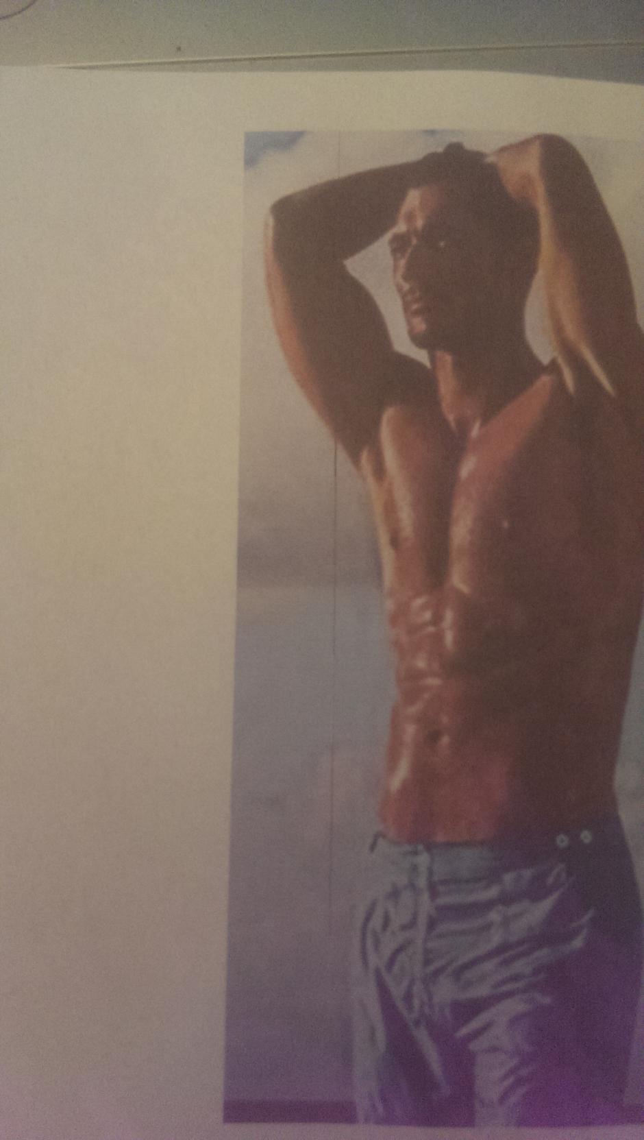

I have just gone to use the printer since bringing it back from the summer fair. Bugger I now have lines on the prints. Same place every time. Sometimes the length of the whole print sometimes just dashes. If I move image no lines. This image shows the 2 different positions i have printed. The image in the middle of the paper has no lines has no lines This image printed on the top right has a line below Mr Gandys arm.

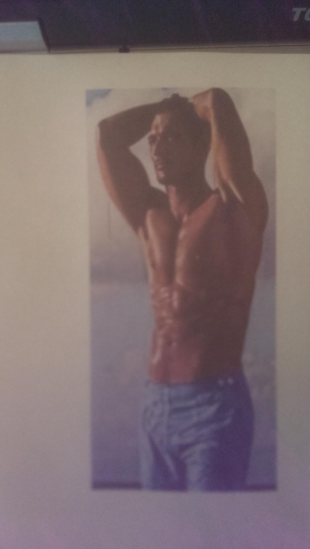

This images has the line the whole length printed in top right of paper.
I have done nozzle checks, all ok, have done 3 head cleans, not done individual cleans yet. I have printed about 6 sheets to date and the line is not going.
I know they are not the greatest photos. I have been printing these onto normal paper as I don't want to waste sub paper trying to sort it out.
All printed on Ricoh A4 3110.

I've seen lines before, but usually caused by blocked nozzles, which doesn't seem to be your problem. The 20 sheets of normal paper - are they all with this same image? Might seem stupid, but I've on occasion come across problematic images that print weird, even when they look ok on screen. Trying another one can't do any harm.
Oh, and if you print a blank page, do you still get the line? If so, might be ink on the roller?

Just printed a report sheet, not a mark, printed another nozzle check no marks and finally printed another image whole A4 page a nothing. So maybe it was just the original image. Thanks for your advice spongerobinson.
