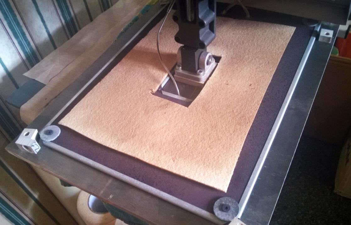

We have a Novachrome Deep Impact 20" x 15" Heat press problem which has developed a fault. The unit has been working ok until recently when we noticed that on large sublimation prints one side was not pressed correctly indicating a slightly cooler platen side. Now the despite the unit switching ok it is not heating up. Removing the control panel lid shows all wires intact and non burnt etc. Going through to the platen we notice there is a what looks like a silver metal thermostat wire along with the 2 mains wires. Are the thermostat cables a possible cause of these cooling down or does it sound like the platen has failed ?

this is the existing element .... anyone know where they may be available from ?
surely a replacement element has to be far cheaper than £280 for a full platen replacement. The existing platen is mint condition ..
