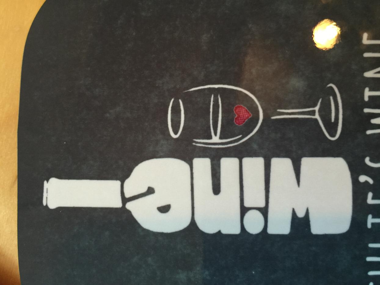

Hi,
Wondering if anyone can help...
When I print my coasters, especially dark colours...they have a tendancy to come out mottled (see attached picture). I am using a cheap swing press from BMS and am printing at 190 for 60 seconds.
Would really appreciate any guidance as to what needs adjusting!

All black is hard to do on coaster, try taking out the moisture by pressing it for 10 secs

Thank you so much, that - and adjusting temp to 200 seem to have done the trick :)

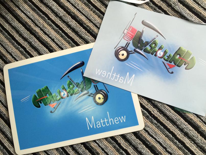

justme
Posts: 79
Joined: 16 Mar 2011, 10:49
Re: Mottled coaster printing
Post by justme »
[ATTACH=CONFIG]3809[/ATTACH]
OK, so I got bolder after your help (thank you!) and thought I'd try a placemat. I have done pre-pressed this and I have pressed at 200 for 75 seconds. The edges are great but the middle is faded. What do you think I need to adjust for this? Would be grateful for any help!
vB_ID:3809
vB_ID:3809
http://www.NameArt.co.uk - owner and designer :) ...oh and mug presser!
mrs maggot
Posts: 3452
Joined: 17 Dec 2009, 05:00
Post by mrs maggot »
Pressure is not even on the press, so you have a bit of a soft spot in the middle, by the looks of it
Andrew
Posts: 2086
Joined: 01 Dec 2009, 05:00
Post by Andrew »
You need to turn the pressure up so it is nice and firm.
