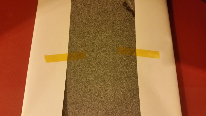

scotty44
Posts: 218
Joined: 11 May 2014, 23:59
Re: Heat tape marks on photo rock slate after heat pressing
Post by scotty44 »
As said above, keep the tape away from the image.... only need to tape it on the back of the slate!
If it's leaving marks on the rear I would overlap the paper on the rear, then tape, dont think marks on the rear would be a problem though!
vB_ID:3882
vB_ID:3882
2015-12-20 17.58.48.jpg (97 KiB) Viewed 27 times
