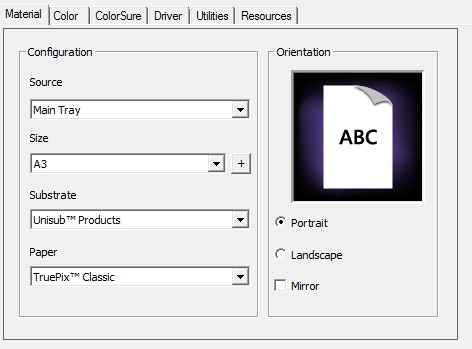

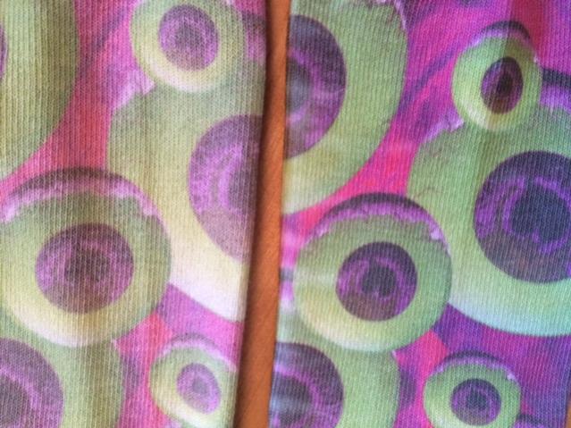

Hi all. just started using our sawgrass sg800 and have a very odd problem. Our colours looked a bit washed out/faded but something even odder happened when i did a quick test hand wash of one of our socks. There was colour loss from the wash and it's visibly more faded than the non-washed sock (tried to take a photo but my camera wont pick it up).
Our setup is as follows...
  • BMS printerowners sublimation socks
  • RGB colour space
  • printed from a pdf in acrobat using powerdriver
  • paper: dyesub magic (magic touch)
  • temp: 200 degrees C (392 degrees F)
  • pressure: high
  • press time: 70 seconds

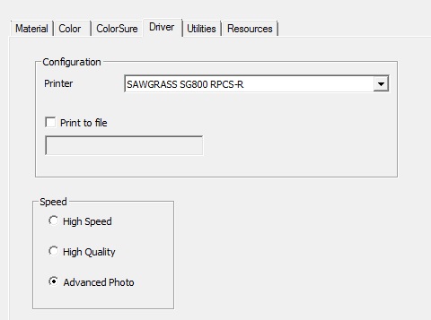

screenshots as follows showing our power driver settings:
vB_ID:3931
vB_ID:3931
setup b.jpg (24.46 KiB) Viewed 277 times
vB_ID:3931
vB_ID:3931
thanks in advance,
vB_ID:3930
vB_ID:3930
setup a.jpg (34.2 KiB) Viewed 277 times

forgot to say we are using sublijet HD ink from sawgrass. It came as a package with the printer.
I've attached as good a photo as i can get of the washing out. Its more noticeable in real life...
vB_ID:3932
vB_ID:3932
outercross
Posts: 5
Joined: 14 Mar 2016, 19:18
Re: sublimation colours came out in washing!
Post by outercross »
Just emailed the sock supplier (BMS printer owners) and they confirm they are polyester.
socks are not especially ribbed when compared to nike elites or similar.
any idea where I can go from here????
