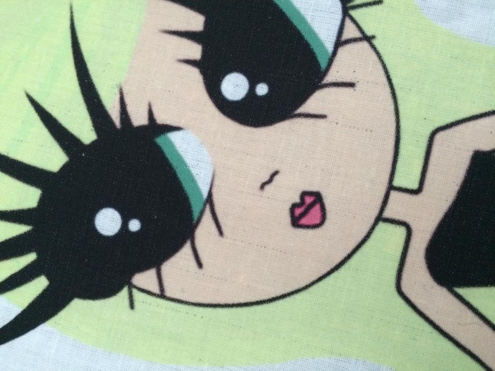

Hi
I wonder if anyone can help? I have printed an image using sublitocotton paper onto a cotton bag. The colours have come out lovely, but there are small black dotted lines running through parts of the image. I also tried this on a natural canvas colour bag and the same issue occurred.
Does anyone know why this could be happening?

What printer? Almost sounds like little wheel marks from the paper feed.

Hi Justin. It's an Epson WF-3010DW. It's my neighbour that actually does the sublimation so I was waiting for her to reply. I will upload a photo of what I mean. Appreciate your help.

Does look like wheel marks where the paper has been fed through. Put a blank sheet through with nothing printed, see if they still show. Have a head clean as well, why not.
