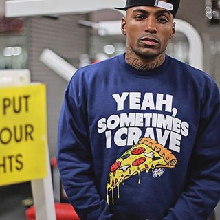

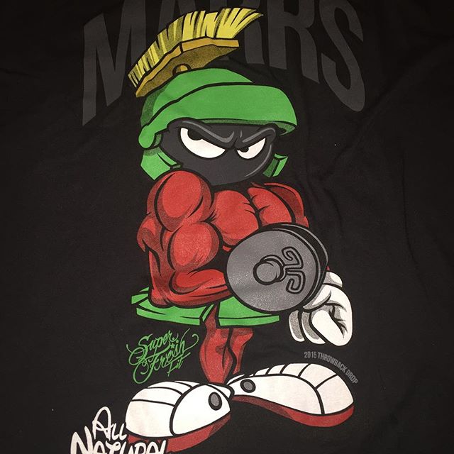

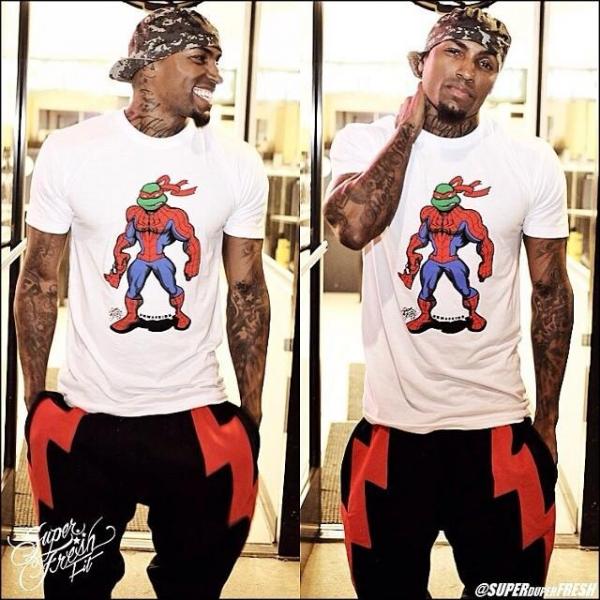

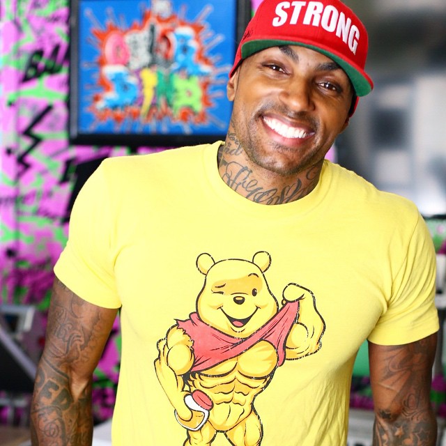

Im looking at the gym market with colourful gym referenced images. The following t-shirts are what i would be aiming for. I'm trying to get away from the usual logo 'monster nutrition' 'killer gorilla' and all those other lame names and focus on cartoony mash ups of cartoon characters.
I want to be the uk version of this :
and get away from
Typical T-shirts.
Would the t-shirts be screen printed or vinyl pressed?

Thanks @Paul and @Arfermo ... Would you think those T-shirts are screen printed in the examples?
I'm not vinyl will look a bit tacky with it looking quite shiny etc

The images will either be DTG or screen printed in large numbers
DTG doesn't like polyester/performance apparel
