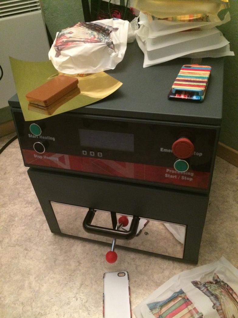

Hello everybody, I received 2 weeks ago a new machine that Sunfly recently made (I think it's not yet in their catalog but well). It can do 2 cases at 115C for 180S.
Video:
(In this video, the machine is naked, here is how it looks really.)
vB_ID:4072
vB_ID:4072
I paid $900 for the machine (normally $1000 I asked a discount lol), $200 for jigs (2x iPhone & 6x Samsung Galaxy), $45 for 50 sheets of A4 film and $315 for shipping to France by DHL (invoice total: $1460). Total payment was €1315.60 with bank fees, I also paid €153 VAT (declared customs value was $250) when I received it. It took 2 weeks to produce and ship, the machine weighs roughly 60kg in its carton so don't go to pick it up alone.
As for the machine, it works fine. I recommend using their transparent film which is resistant to leaks/cracking as well as their plastic blanks (specially made for film). Before using the machine, I preheat it at 115C for about 40 minutes.

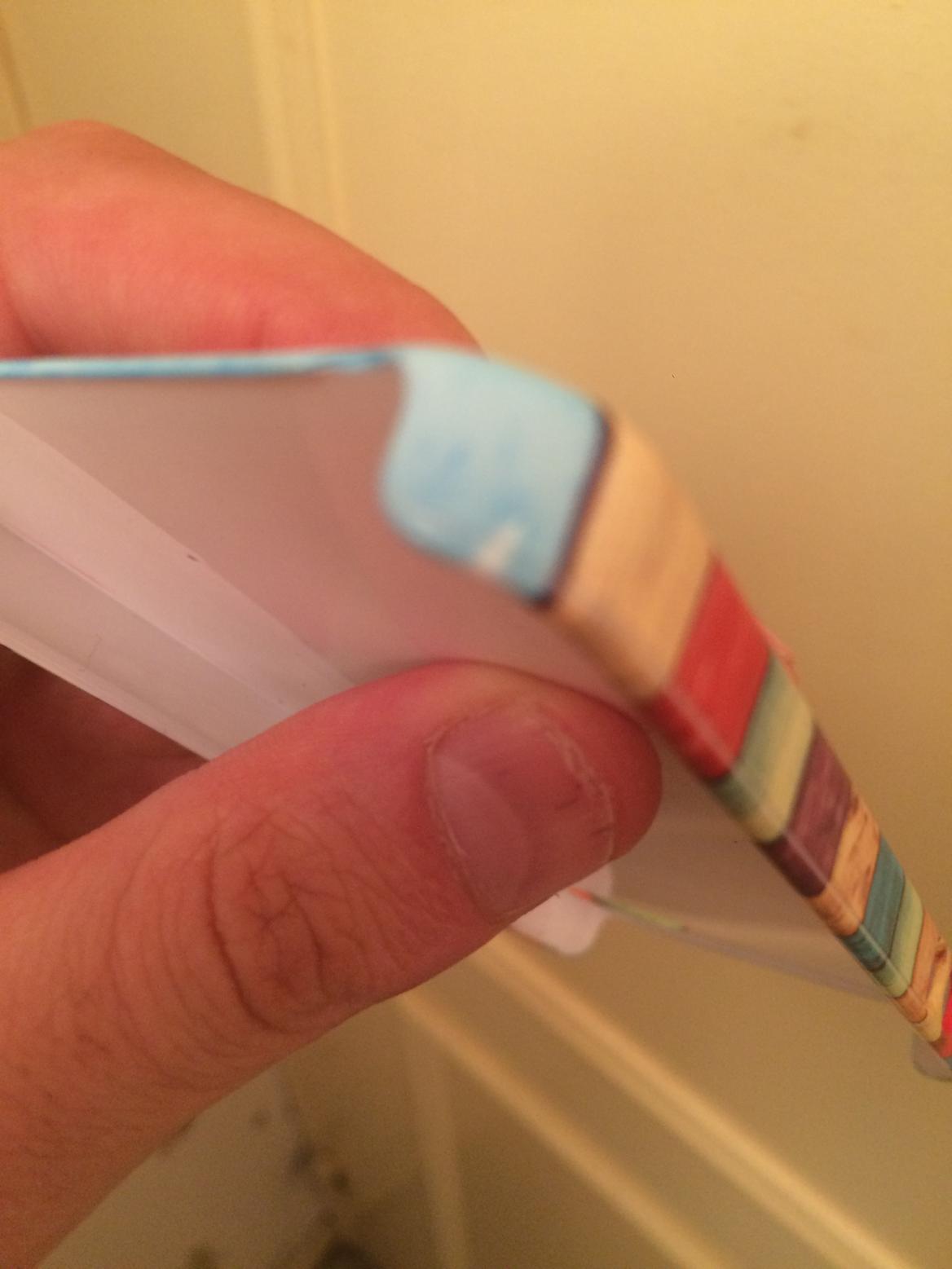

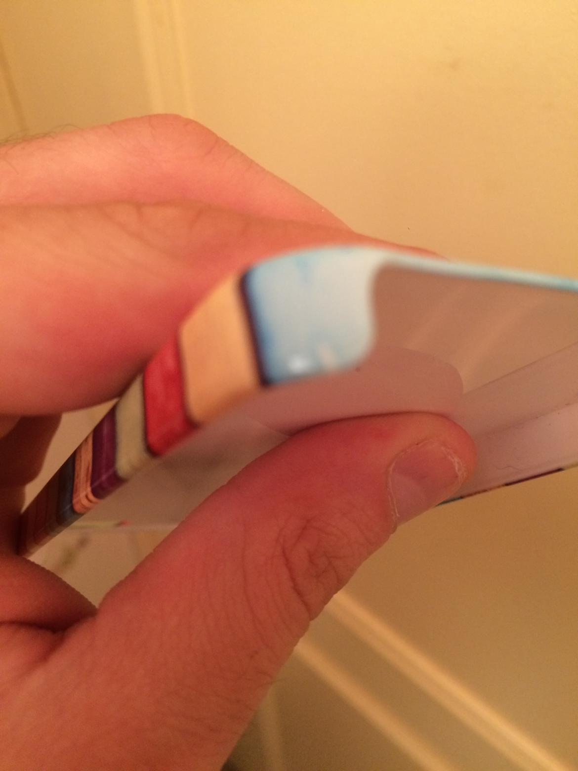

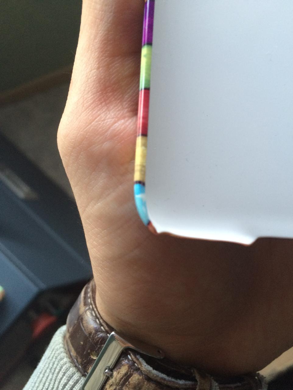

Do the corners come out okay on something like an iPhone 5 with a 90 degree angle and are there any issues with the film bursting with certain cases?

As for the corners, it may happen that they don't fold perfectly (especially iPhone 4 & 5, other models that have round corners have less problems). I'm working out this issue with Sunfly.
