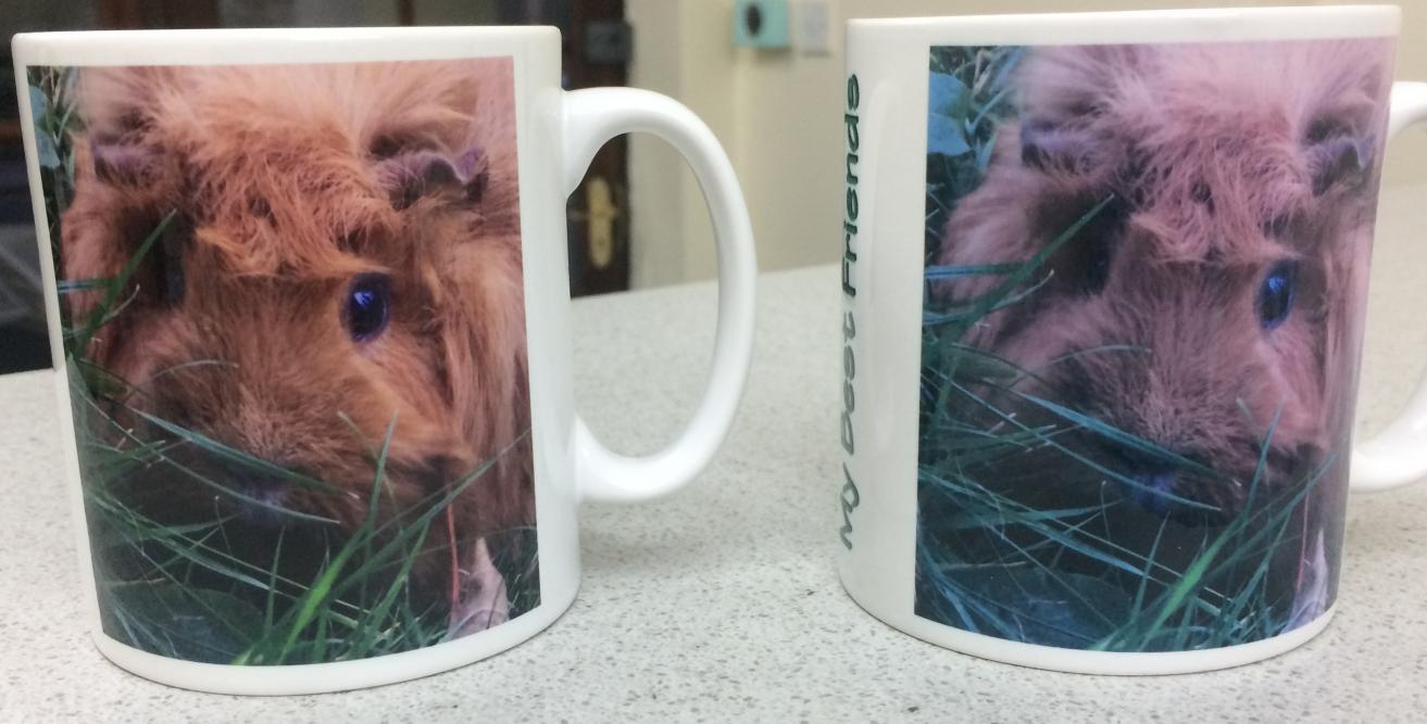

Probably the last update to this thread - the SG800 arrived earlier today, after setting it up we printed and pressed the same image that confirmed the problem last week. I've attached a somewhat poor photo (taken in a hurry on a phone, with poor lighting), which shows the difference between the two!
vB_ID:4299
vB_ID:4299
Regards,
Will.
