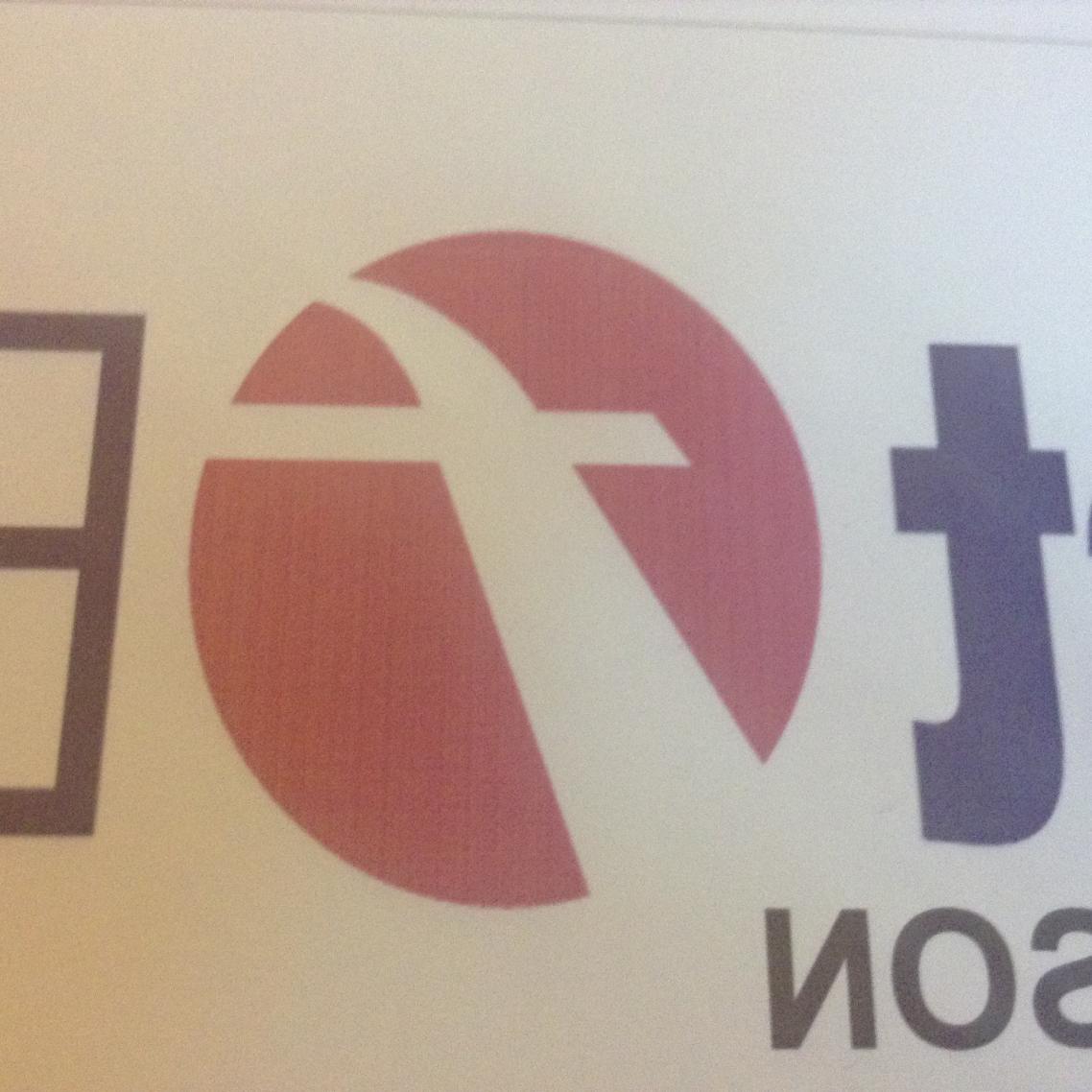

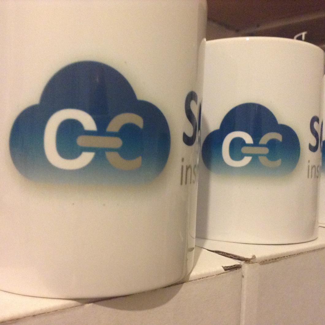

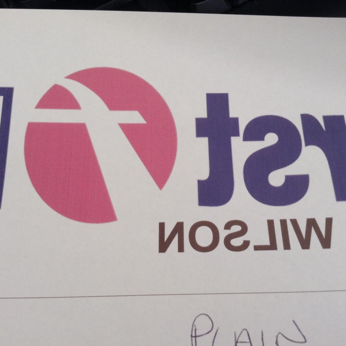

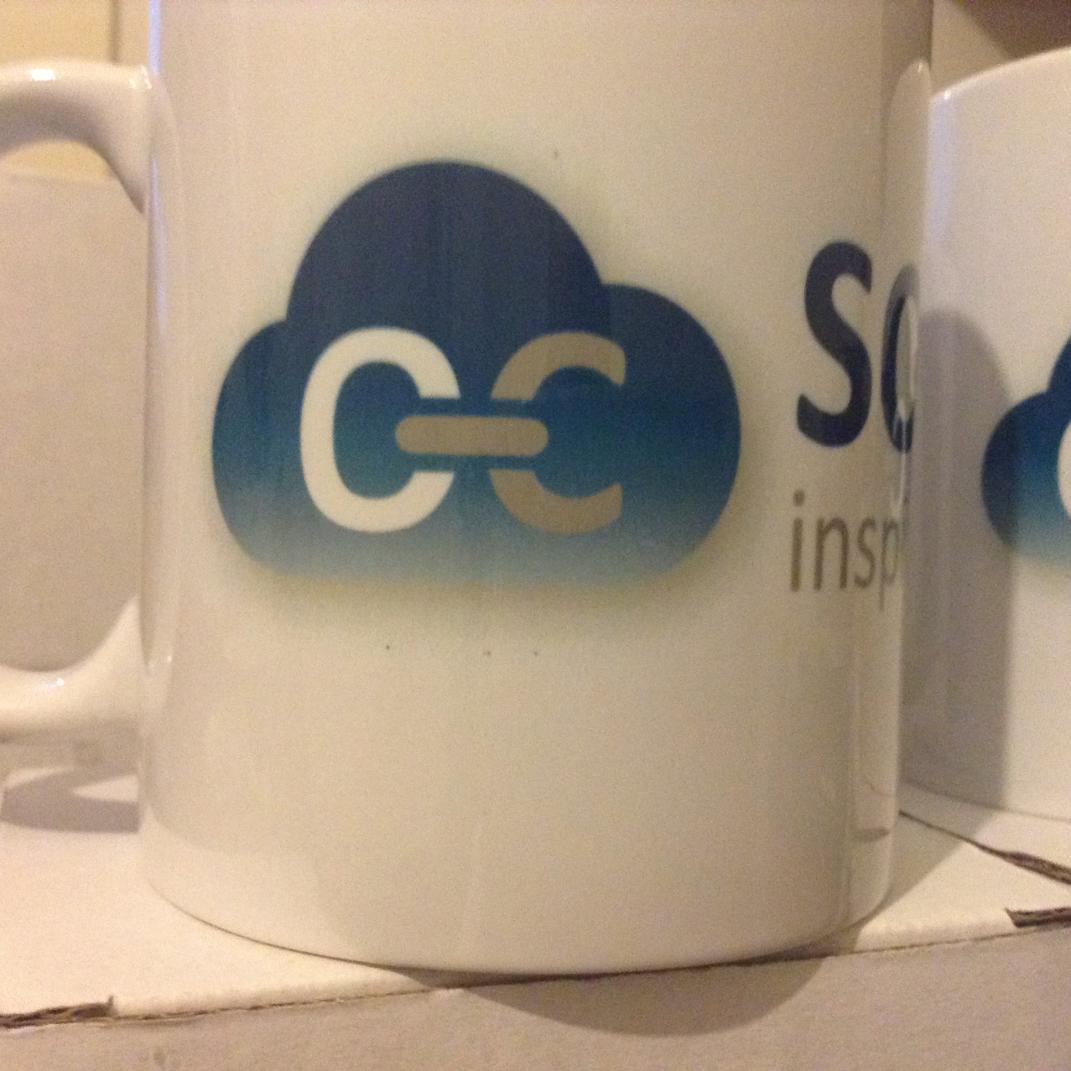

I Bought a Ricoh SG3110DN printer package from CityInk and I have had no end of problems, I am using Photoshop cc 2015 and have the ICC profiles as directed by CityInk, I have had the following issues so far:
- Air Pockets in printer tube (fixed, seemed it was a broken cartridge)
- Banding (Still ongoing with some images)
- Streaky Images on certain colours (Still ongoing)
- Specs on printed mug, but not on paper (still ongoing)
I am using CityInks Own Inks & refillable cartridges(FotoRite Sublimation ink), Sub paper and their Profile for Photoshop cc as well as their profile on the computer, I have flushed several times, Head cleaned several times, Nozzle checks (all look good), Head alignment, breather holes all open, I have also tried other print paper settings and no luck, CityInk are being helpful but taking time to reply, had replacement cartridge and printer but still having issues now 1 week behind, can anyone help? I am mid process on a big order and have to stop until issues are fixed.

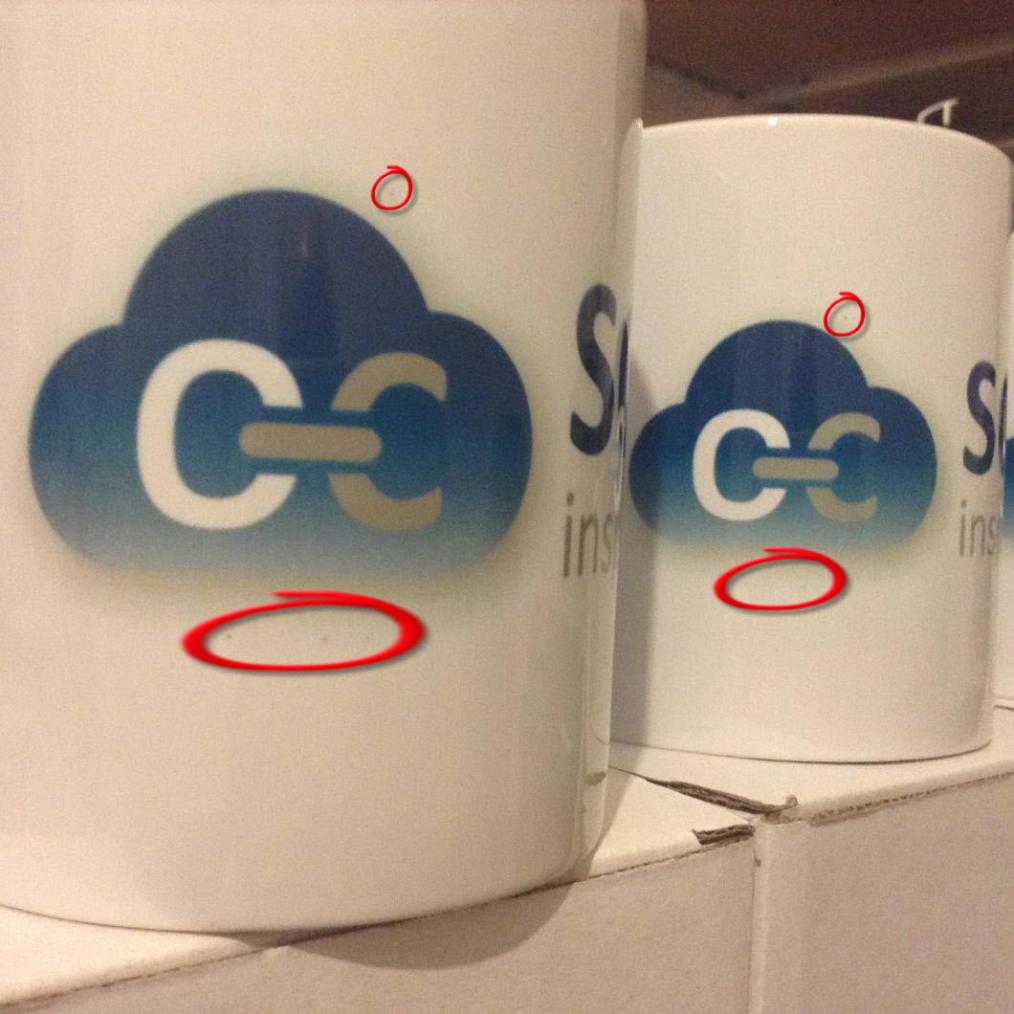

I can see you re printer is having some problems but don't just throw money at it until you know exactly what's causing them.
People are keen on recommending changing printer, inks and paper, but I can see one problem straight away that has nothing to do with any of those.
You have an image of two mugs with THE SAME dot pattern on both in exactly the same place.. This is a problem with your image, not with your kit ...
Seriously, no offence, but you need to learn how to use Photoshop to clean up your images before you print them, especially before taking on large orders.
Re: Several issues Ricoh 3110DN
Have checked the image on ps and these specs are not on the image close up or when printed on the sub paper, no splashing from the ink, only after pressing they seem to appear, I printed a tester on a 10oz mug which I showed the customer and no specs, upgraded to 11oz mug as couldn't get the 10oz at the time and now the specs appear, but not with the other image
also the image was a photoshop image from the company

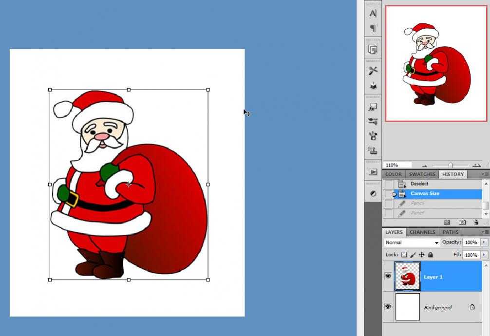

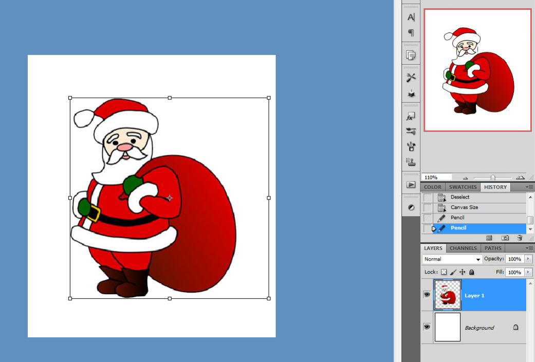

Hi. Tiny dots are very hard to spot in Photoshop, particularly when they are nearly the same colour as the background.
Here's a trick for spotting them...
This is a Santa transparent layer. As you can see, the selection box extends to the right of Santa's sack, meaning that there is data in the transparent area to the right of the sack.
A quick scrub over with the eraser will remove anything in that area, even if you can't see it and you will see the selection box fits snugly to Santa now.
