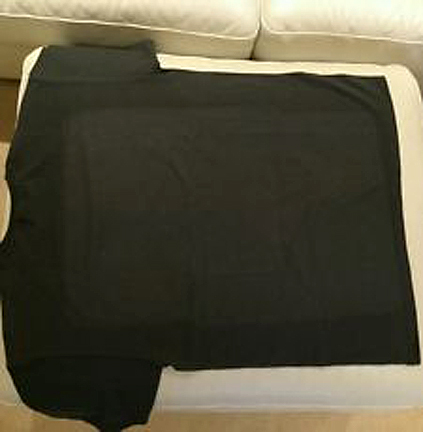

Any idea why I get a large area, the same size as the press platen, on the rear of dark T Shirts? Too high pressure or overheating? I have attached an image.

I've just done my first run of 16 black T's with white vinyl transfers, and one white T with black vinyl transfer for a hen party (my niece's friend). The vinyl transfer all came out great but the press left platen marks on most of the shirts. These shirts were all bought individually by the lasses involved and were of many different designs and materials. The pure cotton ones were no problem at all, as were many of the poly-cotton ones, but the tri-blends (containing viscose, elastane, etc) were a problem, both with platen marks and a smooth, glossy finish, which may have been the result of pressing with a teflon sheet. All vinyl was MDP HotFlex pressed at 160 deg C for 15 secs, peeled, then repressed for 5 secs.
I'm assuming many of you have come across this problem before and just wanted to know if anyone can point me in the right direction for any future jobs I may do. I realise that letting them buy their own T's was a mistake! I'll suggest to any future customers that cotton or poly-cotton is advisable, or even supply the shirts myself.
Ironing the affected shirts has reduced the press marks somewhat, but I was wondering if washing then ironing would reduce them even further? Would a Teflon pillow, or some other padding have helped?

Hi, i know this is an old thread now, but may help others for future ref, I have had similar problems.
What has helped me so far is using Teflon Pillows similar size to the print you are trying to press, and additionally also using a rubber sheet over the garment instead of Teflon.
The rubber sheets will need to be warmed up before every use (I just hover the platen over it before pressing for about 10/20 seconds, then feel the rubber to ensure its warm enough). You will also need to add an additional 5-10 seconds dwell time to your presses too to compensate for the thickness of the rubber sheet.
But the combination of Teflon Pillow underneath your garment and Rubber Sheet over it has really helped alleviate most of my pressing and scorching issues when working with Poly garments.

Colour usually comes back on cotton when the garment has cooled and been in the air for a while.
Polyester is a bit different. On cheaper garments - where the manufacturer has saved money in production of the yarn - the dyed yarn hasn't always been heat set fully. Heat from the heatpress will cause some 'gassing out' of the dye, leading to slight colour loss.
Blends containiing elastaine can be a problem because you are partially melting the elastaine and the garment can end up with a sheen on top of any colour loss.

Thanks pw66 Im using 100% Polyester garments, where the manufacturer suggests pre-washing before sublimation or HTV.
From your experience does this help alleviate issues too?
Re: Press Marks on Dark T Shirts
A little. HTV uses lower temp than sublimation so the colour change isn't so bad.juggysingh;138742 wrote:Thanks pw66 Im using 100% Polyester garments, where the manufacturer suggests pre-washing before sublimation or HTV.
Try using a low temperature vinyl at 130c to reduce the problem, such as TMT 123.
