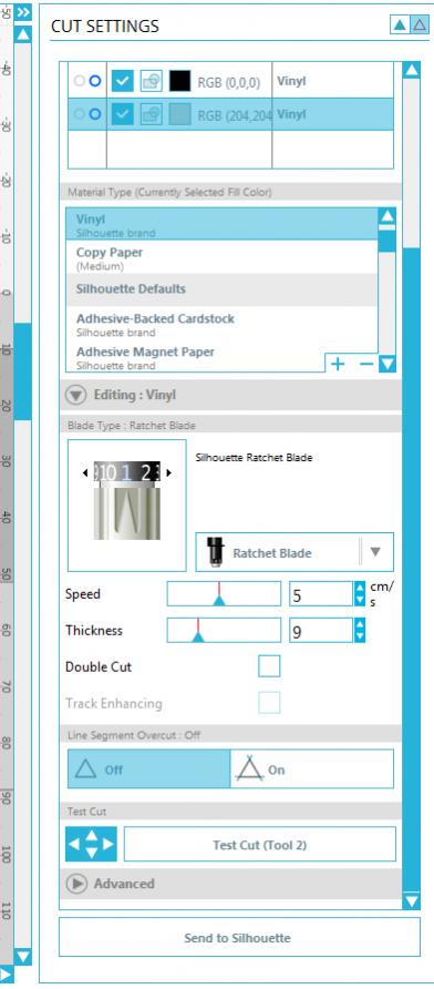

I use mine almost everyday for small vinyl stuff...these are my setting and it cut's fine... It's a cam3 but my other one is a 2 and works with the same settings.. deffo try a new blade
