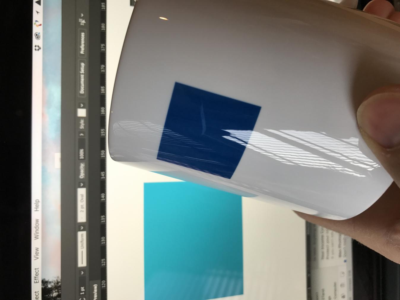

I'm having real problems with colour matching. It's something which has plagued me for years... I manage to get away with it, but I now HAVE to get a colour right as it's a company logo.
I checked that the ink levels are all ok on the printer (Ricoh 3110), that the image is CMYK profile from photoshop and that I am working in CMYK in Adobe Illustrator.
Yet the colour isn't even close when it gets printed. I am using a mac.

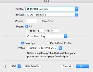

I do have the sublijet profile installed, but it's not visible anywhere to select? Does the colour space in Illustrator matter or is it literally the profile on the print dialogue which should be sawgrass?
I found a color sync profile which says it's sublijet profile for my printer. I guess that would be the place to start!?

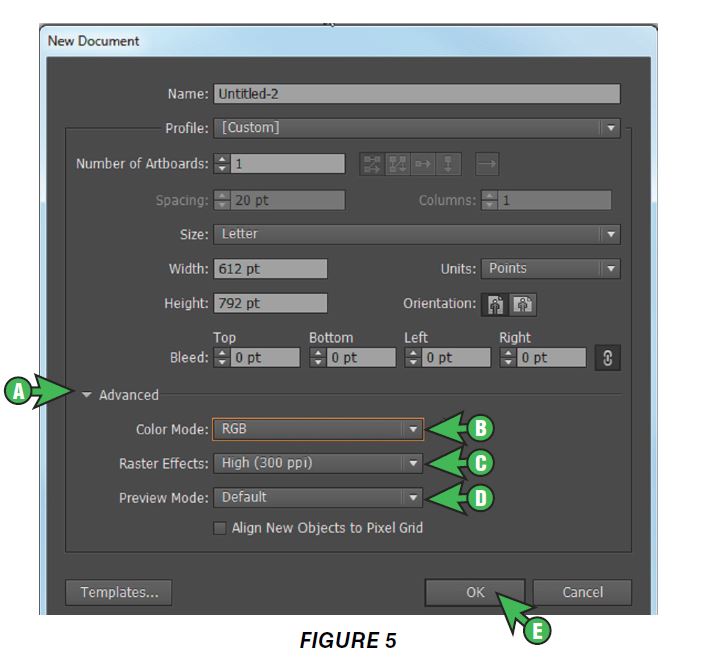

Hi Matt,
Check the documentation on the Sawgrass site for the setup. My Photoshop setup for Ricoh 7700 uses RGB for the document not CMYK.
It's one of the odd things with the Ricoh printers 4 ink colours but RGB profile.
Here's the AI set up for Windows from Sawgrass pdf-
Skye
Skye
