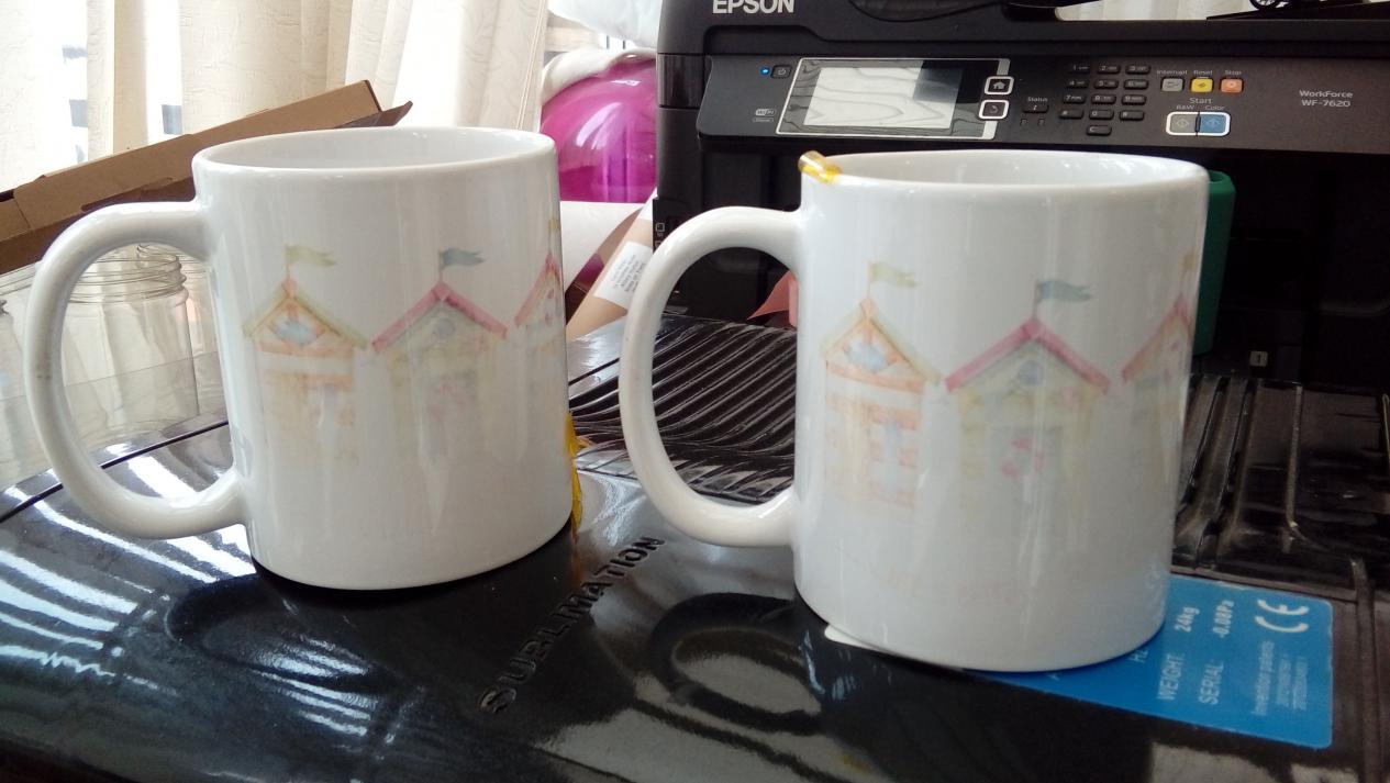

well, I've had an epic fail and i dont know what I've done
I put 2 mugs on at 190 for 9 minutes, I stood them normal way up on the bottom of the heat press. I did see some videos that seemed to have a grill on the bottom but ours hasn't got one.
It seems to be perfect at the top and nothing at the bottom. gggrrrr
Re: Mugs, do you put in warm water or not?.....
Wow! Nine minutes is a long time in the press!
What press do you have? Are you sure your temperature is set to Celsius and not Fahrenheit?
Maybe try turning a mug upside down half way through pressing. Mind you, your whole print looks faded to me.
We have a ST3042, its 190 C definately
I can't find the correct key for the little "o". The design is quite light as its a watercolour image but the top is fine
im wondering if i need to put a grill in the bottom.
