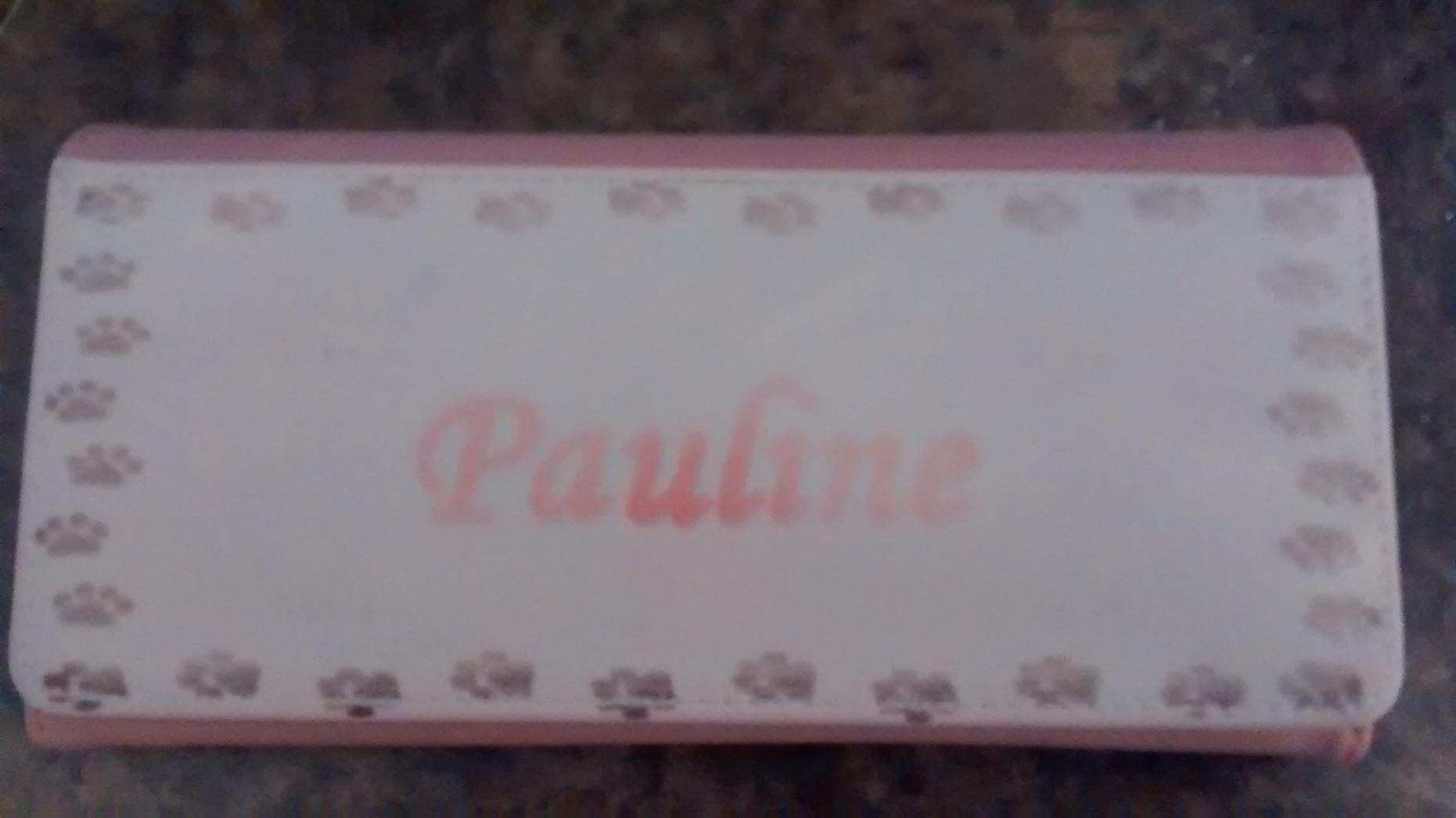

I am having real problems at present.
I was subbing glass clocks, coasters, key rings etc with no problem.
I bought a purse from Isub supplies and followed their advice about printing and pressing.
This came out of the printer fine but was very pale after pressing.
I decided I would try pressing again with a much darker print to try and cover up the original, however it still came out very pale.
Any ideas what I am doing wrong.

Could be a number of things, first that springs to mind would be press, are you getting a good even heat without cold spots?
Re: pale subbing
do you set your press to Celsius values but press is in Fahrenheit?

Justin just had it serviced at adkins replaced alot of parts but have said it is now as good as new.
Paul I haven't done anything different to what I have always done, Its almost as though the paper is not releasing the ink.

wrong side of paper?
Re: pale subbing
Yeah, double-check your paper is the right way up. Believe me, it happens!

The paper was the right way round but I loaded it onto the press paper on the bottom instead of on the top, tried it this morning and came out fine.
